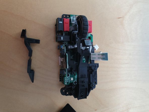

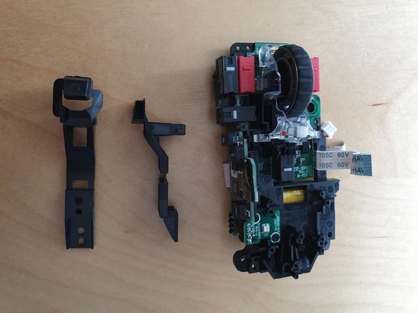

    • Remove these 2 screws and remove the 2 top button pieces.
