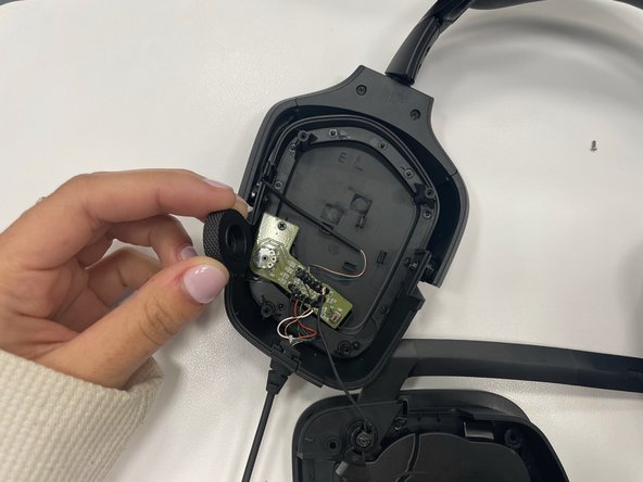

  3. Logitech G432 Volume Button Replacement: crwdns2935265:03crwdnd2935265:01crwdnd2935265:01crwdne2935265:0
    • Gently open the headpiece to prevent accidentally pulling apart any of the internal wiring.
  4. Logitech G432 Volume Button Replacement: crwdns2935265:04crwdnd2935265:01crwdnd2935265:02crwdne2935265:0 Logitech G432 Volume Button Replacement: crwdns2935265:04crwdnd2935265:02crwdnd2935265:02crwdne2935265:0
    • To adjust and fix the volume button, use a Phillips #0 screwdriver to tighten, loosen, or remove the 1.0 mm screw located on the left side.
