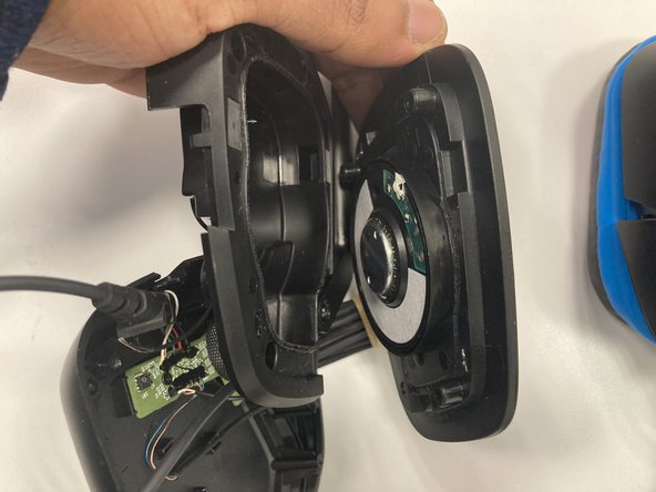

    2. Logitech G432 Speaker Replacement: crwdns2935265:03crwdnd2935265:01crwdnd2935265:01crwdne2935265:0
      • Gently open the headpiece to prevent accidentally pulling apart any of the internal wiring.
    3. Logitech G432 Speaker Replacement: crwdns2935265:04crwdnd2935265:01crwdnd2935265:02crwdne2935265:0 Logitech G432 Speaker Replacement: crwdns2935265:04crwdnd2935265:02crwdnd2935265:02crwdne2935265:0
      • Using an iFixit opening tool, separate the four black tabs by pushing them away from each other to unclip them.
      • Gently pull apart the outside shell of the headpiece to reveal the speaker.

Hey, I have issues trying to remove the speaker itself from the other piece, so I cant place the new one, any suggestions?
