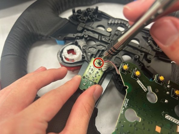

  4. Logitech G29 Driving Force Red Dial Replacement: crwdns2935265:04crwdnd2935265:01crwdnd2935265:02crwdne2935265:0 Logitech G29 Driving Force Red Dial Replacement: crwdns2935265:04crwdnd2935265:02crwdnd2935265:02crwdne2935265:0
    • Press in the 3 red tabs located on the inside black housing of the dial. Using the medium sized tweezers, the black center button was pushed out to reveal 3 small black screws.
    • Using the same bit as earlier, bit Ph #00 remove the three 3.32mm diameter 5mm length screws to release the red dial.
