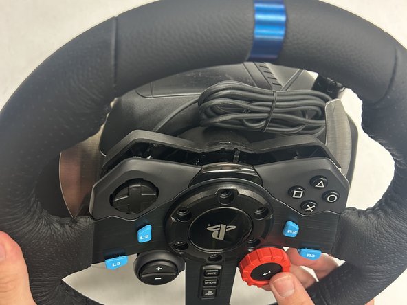

    • Remove the six black screws holding the Playstation center cap using the Hex 4.0 bit.
    • The outer diameter of these screws are 8.40mm with a length of 26mm.
    • The wheel is still attached the base via a bundled cable-connector.

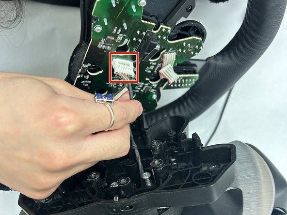

    • Gently lift the faceplate and wheel off the stand.
    • Pull the white 7-pin cable connector from the wheel PCB.
    • Use a spudger or plastic opening tool to help free the connector at its base. Do not pull on the wires.

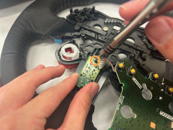

    • Use a Phillips #1 screwdriver to remove the seven 8 mm silver screws that secure the main wheel PCB.
    • Use a Phillips #00 screwdriver to remove the single 5 mm screw from the Share/Options/PlayStation button PCB.
