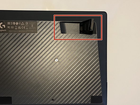

    • Flip the keyboard so the keys are facedown on a flat surface.
    • Locate both plastic feet on the top left and top right of the back board.
  2. Logitech G213 Prodigy Adjustable Feet Replacement: crwdns2935265:02crwdnd2935265:01crwdnd2935265:02crwdne2935265:0 Logitech G213 Prodigy Adjustable Feet Replacement: crwdns2935265:02crwdnd2935265:02crwdnd2935265:02crwdne2935265:0
    • Lift the foot into a fully open position.
    • The foot should press flat against the outer edge of its socket.

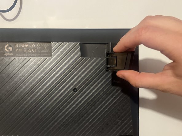

  3. Logitech G213 Prodigy Adjustable Feet Replacement: crwdns2935265:03crwdnd2935265:01crwdnd2935265:02crwdne2935265:0 Logitech G213 Prodigy Adjustable Feet Replacement: crwdns2935265:03crwdnd2935265:02crwdnd2935265:02crwdne2935265:0
    • Gently but firmly squeeze the sides of the foot until it pops out of place.
