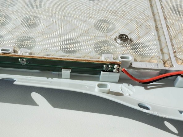

  9. Logitech G15 Gaming Keyboard 1st Generation (867619-0403) LED Backlights Replacement, Extract the LED plates: crwdns2935265:09crwdnd2935265:01crwdnd2935265:03crwdne2935265:0 Logitech G15 Gaming Keyboard 1st Generation (867619-0403) LED Backlights Replacement, Extract the LED plates: crwdns2935265:09crwdnd2935265:02crwdnd2935265:03crwdne2935265:0 Logitech G15 Gaming Keyboard 1st Generation (867619-0403) LED Backlights Replacement, Extract the LED plates: crwdns2935265:09crwdnd2935265:03crwdnd2935265:03crwdne2935265:0
    • As you now have the main board separated from the back panel, turn it over.
    • You can now extract the LED plates from the bottom of the keyboard.
    • Now it's time to install the replacement board, or to replace the LEDs on this plate.

When will step 8 and beyond be added?
BloodShed - crwdns2934203:0crwdne2934203:0
Been busy with COVID-19 and all. I can try to work on it today some more. Anything in particular you need help with?
PsiFire -
Separating the ‘light’ plate and removing the LED’s what type I replace them with, comes to mind.
I ended up getting these: https://www.ebay.com/itm/120973346340
I was optimistic about the result when it was apart but when all back together and it had time to “burn in” the lights still seem a bit dim. If you can get your hands on something brighter, I might suggest using that but YMMV. The stats on those bulbs could provide with at least a starting point.
