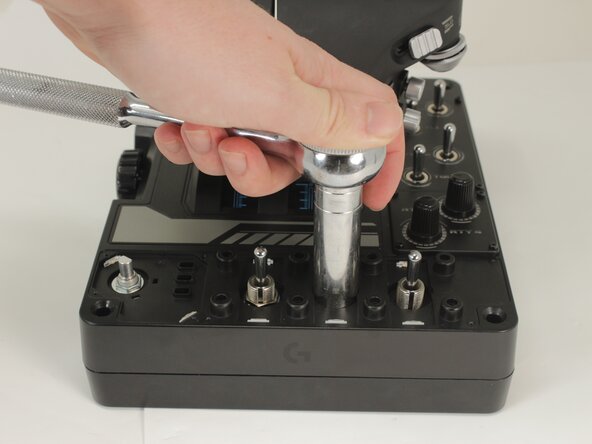

  5. Logitech G X56 HOTAS Throttle Mode Switch Potentiometer Replacement, Mode Switch Potentiometer: crwdns2935265:05crwdnd2935265:01crwdnd2935265:02crwdne2935265:0 Logitech G X56 HOTAS Throttle Mode Switch Potentiometer Replacement, Mode Switch Potentiometer: crwdns2935265:05crwdnd2935265:02crwdnd2935265:02crwdne2935265:0
    • Use an 11 mm deep socket to remove the nut from the post of the switch.

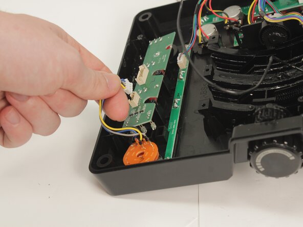

  6. Logitech G X56 HOTAS Throttle Mode Switch Potentiometer Replacement: crwdns2935265:06crwdnd2935265:01crwdnd2935265:02crwdne2935265:0 Logitech G X56 HOTAS Throttle Mode Switch Potentiometer Replacement: crwdns2935265:06crwdnd2935265:02crwdnd2935265:02crwdne2935265:0
    • Flip the throttle over.
    • The mode switch potentiometer is identifiable by the orange plastic contact board.
    • Disconnect the potentiometer connector from the PCB by pulling it straight up and out of its socket.
