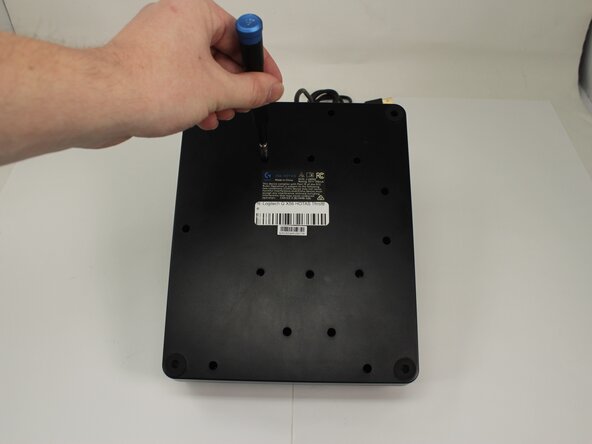

    • Place the throttle upside down with the bottom panel facing up.
  2. Logitech G X56 HOTAS Throttle Bottom Panel Replacement: crwdns2935265:02crwdnd2935265:01crwdnd2935265:02crwdne2935265:0 Logitech G X56 HOTAS Throttle Bottom Panel Replacement: crwdns2935265:02crwdnd2935265:02crwdnd2935265:02crwdne2935265:0
    • Remove the fifteen 13.6 mm Phillips #1 screws that secure the bottom panel to the base plate.

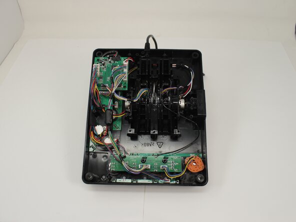

    • Remove the bottom panel by lifting straight up.
