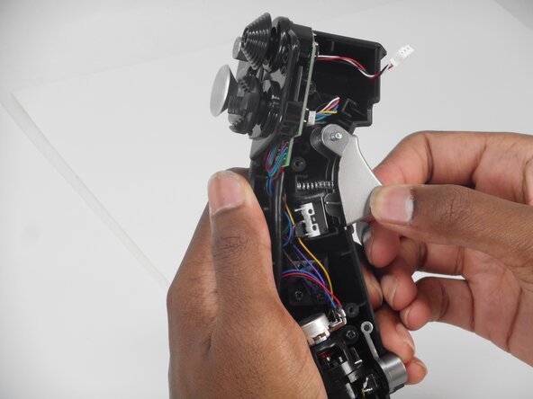

  6. Logitech G X56 HOTAS Joystick Trigger Spring Replacement, Trigger Spring: crwdns2935265:06crwdnd2935265:01crwdnd2935265:02crwdne2935265:0 Logitech G X56 HOTAS Joystick Trigger Spring Replacement, Trigger Spring: crwdns2935265:06crwdnd2935265:02crwdnd2935265:02crwdne2935265:0
    • Locate the trigger button on the left dissembled side of the joystick.

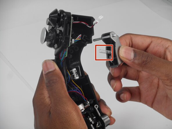

  7. Logitech G X56 HOTAS Joystick Trigger Spring Replacement: crwdns2935265:07crwdnd2935265:01crwdnd2935265:02crwdne2935265:0 Logitech G X56 HOTAS Joystick Trigger Spring Replacement: crwdns2935265:07crwdnd2935265:02crwdnd2935265:02crwdne2935265:0
    • Use two fingers to grab the trigger and pull upwards slowly.
    • The spring attached to the trigger pops out if not done carefully.

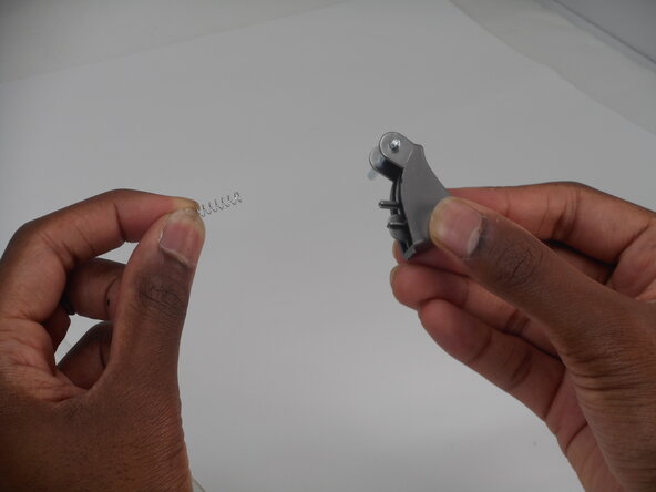

  8. Logitech G X56 HOTAS Joystick Trigger Spring Replacement: crwdns2935265:08crwdnd2935265:01crwdnd2935265:02crwdne2935265:0 Logitech G X56 HOTAS Joystick Trigger Spring Replacement: crwdns2935265:08crwdnd2935265:02crwdnd2935265:02crwdne2935265:0
    • Detach the spring and replace it with a new one.
