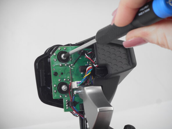

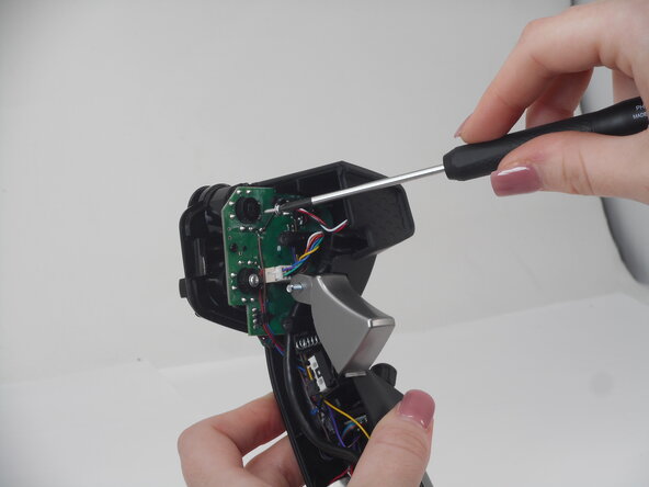

  6. Logitech G X56 HOTAS Joystick Thumb HATs (Witch and Castle) Cover Replacement, Thumb HATs Cover: crwdns2935265:06crwdnd2935265:01crwdnd2935265:03crwdne2935265:0 Logitech G X56 HOTAS Joystick Thumb HATs (Witch and Castle) Cover Replacement, Thumb HATs Cover: crwdns2935265:06crwdnd2935265:02crwdnd2935265:03crwdne2935265:0 Logitech G X56 HOTAS Joystick Thumb HATs (Witch and Castle) Cover Replacement, Thumb HATs Cover: crwdns2935265:06crwdnd2935265:03crwdnd2935265:03crwdne2935265:0
    • Remove the two Phillips #0 6.9 mm-long screws that secure the HAT switch PCB.

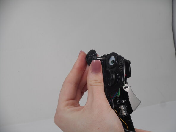

  7. Logitech G X56 HOTAS Joystick Thumb HATs (Witch and Castle) Cover Replacement: crwdns2935265:07crwdnd2935265:01crwdnd2935265:02crwdne2935265:0 Logitech G X56 HOTAS Joystick Thumb HATs (Witch and Castle) Cover Replacement: crwdns2935265:07crwdnd2935265:02crwdnd2935265:02crwdne2935265:0
    • Turn the joystick and remove the HAT cover.
