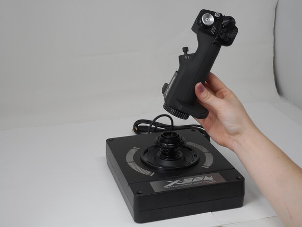

    • Turn the locking bezel counterclockwise until the joystick comes away from the base.

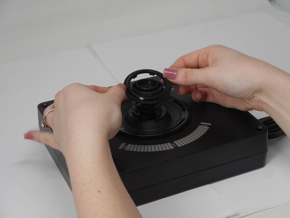

    • Remove the plastic ring by applying pressure and lifting equally on both sides.

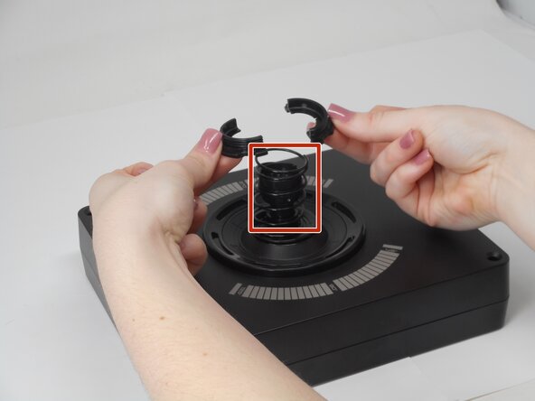

    • There is a locking clamp that locks the spring that splits in two. Take one half of the clamp off, press the spring down, and take the other clamp out.
    • The spring is under compression and pops out if not done carefully.
