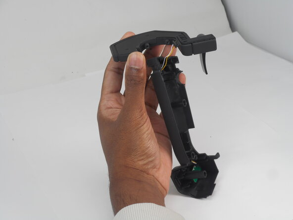

  3. Logitech G X56 HOTAS Joystick Flying Pinky Replacement: crwdns2935265:03crwdnd2935265:01crwdnd2935265:02crwdne2935265:0 Logitech G X56 HOTAS Joystick Flying Pinky Replacement: crwdns2935265:03crwdnd2935265:02crwdnd2935265:02crwdne2935265:0
    • Pull the joystick casing apart to reveal the internal components.
    • The casing will need a little force to split open.
    • Take care not to damage or strain the connected cable.

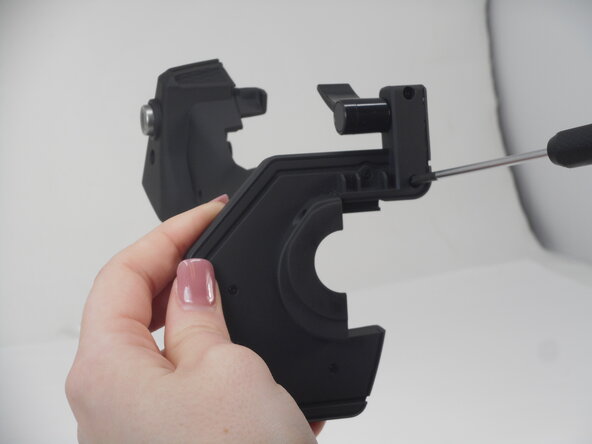

  6. Logitech G X56 HOTAS Joystick Flying Pinky Replacement, Flying Pinky: crwdns2935265:06crwdnd2935265:01crwdnd2935265:03crwdne2935265:0 Logitech G X56 HOTAS Joystick Flying Pinky Replacement, Flying Pinky: crwdns2935265:06crwdnd2935265:02crwdnd2935265:03crwdne2935265:0 Logitech G X56 HOTAS Joystick Flying Pinky Replacement, Flying Pinky: crwdns2935265:06crwdnd2935265:03crwdnd2935265:03crwdne2935265:0
    • Remove the following screws on the underside of the right joystick half:
    • Three Phillips #000 5.7 mm screws
    • Two Phillips #00 6.9 mm screws

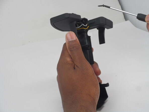

  7. Logitech G X56 HOTAS Joystick Flying Pinky Replacement: crwdns2935265:07crwdnd2935265:01crwdnd2935265:02crwdne2935265:0 Logitech G X56 HOTAS Joystick Flying Pinky Replacement: crwdns2935265:07crwdnd2935265:02crwdnd2935265:02crwdne2935265:0
    • Remove the two Phillips #0 11.7 mm screws.

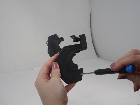

  8. Logitech G X56 HOTAS Joystick Flying Pinky Replacement: crwdns2935265:08crwdnd2935265:01crwdnd2935265:02crwdne2935265:0 Logitech G X56 HOTAS Joystick Flying Pinky Replacement: crwdns2935265:08crwdnd2935265:02crwdnd2935265:02crwdne2935265:0
    • Separate the base plate connected to the joystick casing.
    • Take care not to strain the connected cables.

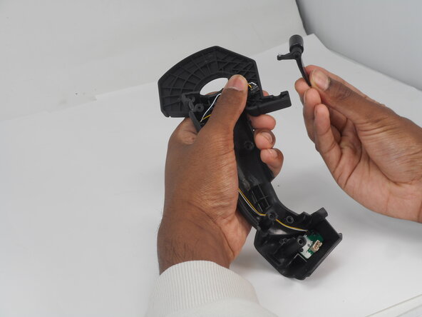

  9. Logitech G X56 HOTAS Joystick Flying Pinky Replacement: crwdns2935265:09crwdnd2935265:01crwdnd2935265:01crwdne2935265:0
    • Remove the top panel of the base plate.
  10. Logitech G X56 HOTAS Joystick Flying Pinky Replacement: crwdns2935265:010crwdnd2935265:01crwdnd2935265:02crwdne2935265:0 Logitech G X56 HOTAS Joystick Flying Pinky Replacement: crwdns2935265:010crwdnd2935265:02crwdnd2935265:02crwdne2935265:0
    • Use your fingers to remove and flying pinky switch.
    • If not done carefully, the yellow and white wiring connecting to the PCB board and the spring attached to the flying pinky will fall out.
