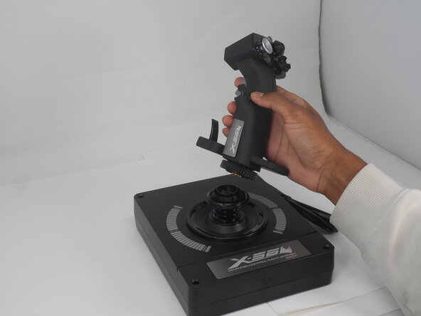

    • Turn the locking bezel counterclockwise, then remove the joystick from the joystick base.

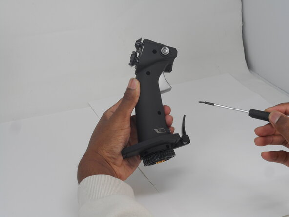

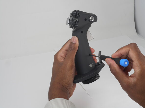

    • Remove the five 11.7 mm-long Phillips #0 screws that secure the case.

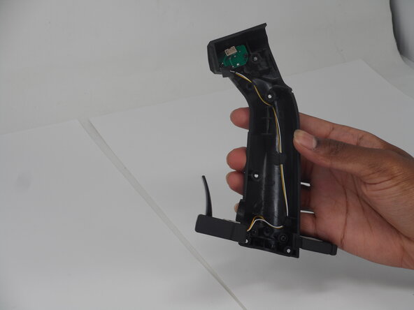

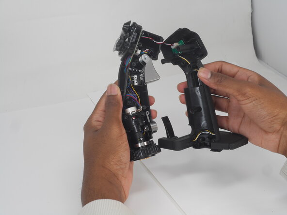

    • Pull the joystick casing apart to reveal the internal components.
    • The casing will need a little force to split open.
    • Take care not to damage or strain the connected cable.

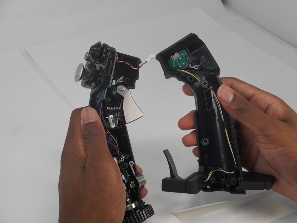

    • Grip and pull the white connector directly out of its socket.
    • The connector is fragile. If removed forcefully, it may affect the PCB performance.
