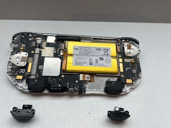

Replacing the L2-R2 triggers for the Logitech G Cloud is sophisticated and can be accomplished in six steps. You will need a wedge tool and a Phillips #00 screwdriver. Carefully read the instructions before starting to disassemble the Logitech G Cloud. You may hear loud popping noises when you remove the interior plating. Once the screws are removed, the triggers should be simple to pop out.
    1. Logitech G Cloud L2-R2 Trigger Replacement, Case: crwdns2935265:01crwdnd2935265:01crwdnd2935265:02crwdne2935265:0 Logitech G Cloud L2-R2 Trigger Replacement, Case: crwdns2935265:01crwdnd2935265:02crwdnd2935265:02crwdne2935265:0
      • Power the device off and turn it over so the screen is face down.
      • Insert an opening pick into the seam between the back plate and left handguard.
      • Pry around the entire perimeter until the handguard fully releases.
      • Remove the handguard.
      • Repeat the previous three bullets on the right handguard.
    2. Logitech G Cloud L2-R2 Trigger Replacement: crwdns2935265:02crwdnd2935265:01crwdnd2935265:01crwdne2935265:0
      • Use a Phillips #00 screwdriver to remove all eight 10 mm screws from the rear case located under where the handguards were.
    3. Logitech G Cloud L2-R2 Trigger Replacement: crwdns2935265:03crwdnd2935265:01crwdnd2935265:02crwdne2935265:0 Logitech G Cloud L2-R2 Trigger Replacement: crwdns2935265:03crwdnd2935265:02crwdnd2935265:02crwdne2935265:0
      • Insert an opening pick into the seam between the midframe and rear case.
      • Gently pry the rear case upwards to separate it from the midframe.
    4. Logitech G Cloud L2-R2 Trigger Replacement: crwdns2935265:04crwdnd2935265:01crwdnd2935265:01crwdne2935265:0
      • Use a Phillips #00 screwdriver to remove all seven 10 mm screws that secure the midframe.
    5. Logitech G Cloud L2-R2 Trigger Replacement: crwdns2935265:05crwdnd2935265:01crwdnd2935265:02crwdne2935265:0 Logitech G Cloud L2-R2 Trigger Replacement: crwdns2935265:05crwdnd2935265:02crwdnd2935265:02crwdne2935265:0
      • Insert an opening pick into the seam between the midframe and front case at the top of the device to separate the interior plating.
      • Gently pry out the midframe by lifting an opening pick.
      • You may hear loud popping noises when you remove the interior plating. That's the sound of the retaining clips disengaging.
    1. Logitech G Cloud L2-R2 Trigger Replacement, L2-R2 Trigger: crwdns2935265:06crwdnd2935265:01crwdnd2935265:02crwdne2935265:0 Logitech G Cloud L2-R2 Trigger Replacement, L2-R2 Trigger: crwdns2935265:06crwdnd2935265:02crwdnd2935265:02crwdne2935265:0
      • Use a Phillips #00 screwdriver to remove all four 10 mm screws that secure the L2 and R2 triggers.
      • Pop the L2 and R2 triggers out with your fingers.
