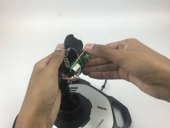

  3. Logitech Extreme 3D Pro Top button circuit board Replacement: crwdns2935265:03crwdnd2935265:01crwdnd2935265:02crwdne2935265:0 Logitech Extreme 3D Pro Top button circuit board Replacement: crwdns2935265:03crwdnd2935265:02crwdnd2935265:02crwdne2935265:0
    • Pull apart the joystick chassis by hand.
    • Release this clip located underneath the hand rest
    • The circuit board will be loose and may fall down.

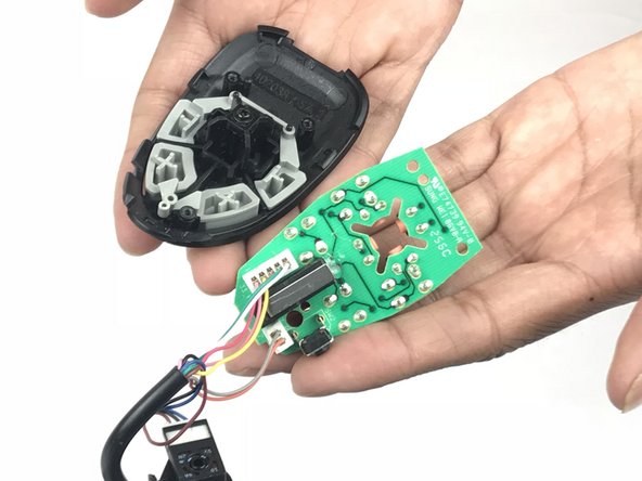

  4. Logitech Extreme 3D Pro Top button circuit board Replacement, Top button circuit board: crwdns2935265:04crwdnd2935265:01crwdnd2935265:03crwdne2935265:0 Logitech Extreme 3D Pro Top button circuit board Replacement, Top button circuit board: crwdns2935265:04crwdnd2935265:02crwdnd2935265:03crwdne2935265:0 Logitech Extreme 3D Pro Top button circuit board Replacement, Top button circuit board: crwdns2935265:04crwdnd2935265:03crwdnd2935265:03crwdne2935265:0
    • Remove the three 7mm Phillips #1 screws from the button board.
    • Remove the button board from the plastic top.
    • When taken apart the plastic buttons can fall out.

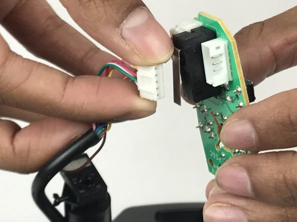

  5. Logitech Extreme 3D Pro Top button circuit board Replacement: crwdns2935265:05crwdnd2935265:01crwdnd2935265:02crwdne2935265:0 Logitech Extreme 3D Pro Top button circuit board Replacement: crwdns2935265:05crwdnd2935265:02crwdnd2935265:02crwdne2935265:0
    • Disconnect the cable from the button board.

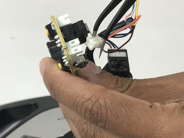

  6. Logitech Extreme 3D Pro Top button circuit board Replacement: crwdns2935265:06crwdnd2935265:01crwdnd2935265:02crwdne2935265:0 Logitech Extreme 3D Pro Top button circuit board Replacement: crwdns2935265:06crwdnd2935265:02crwdnd2935265:02crwdne2935265:0
    • Disconnect the smaller cable from the button board.
