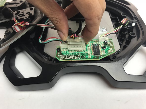

  6. Logitech Extreme 3D Pro Main Joystick Spring Replacement, Main Joystick Spring: crwdns2935265:06crwdnd2935265:01crwdnd2935265:02crwdne2935265:0 Logitech Extreme 3D Pro Main Joystick Spring Replacement, Main Joystick Spring: crwdns2935265:06crwdnd2935265:02crwdnd2935265:02crwdne2935265:0
    • Disconnect the wire from the motherboard.

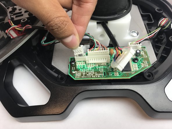

  7. Logitech Extreme 3D Pro Main Joystick Spring Replacement: crwdns2935265:07crwdnd2935265:01crwdnd2935265:02crwdne2935265:0 Logitech Extreme 3D Pro Main Joystick Spring Replacement: crwdns2935265:07crwdnd2935265:02crwdnd2935265:02crwdne2935265:0
    • Remove this plug from the motherboard.

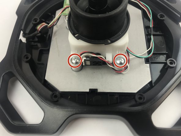

  8. Logitech Extreme 3D Pro Main Joystick Spring Replacement: crwdns2935265:08crwdnd2935265:01crwdnd2935265:02crwdne2935265:0 Logitech Extreme 3D Pro Main Joystick Spring Replacement: crwdns2935265:08crwdnd2935265:02crwdnd2935265:02crwdne2935265:0
    • Remove the four 10mm Phillips #1 screws from the joystick base.
