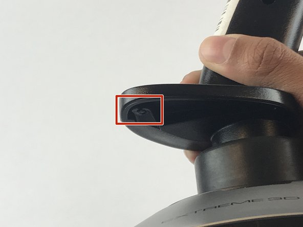

    • Pull apart the joystick chassis by hand.
    • Release this clip located underneath the hand rest
    • The circuit board will be loose and may fall down.

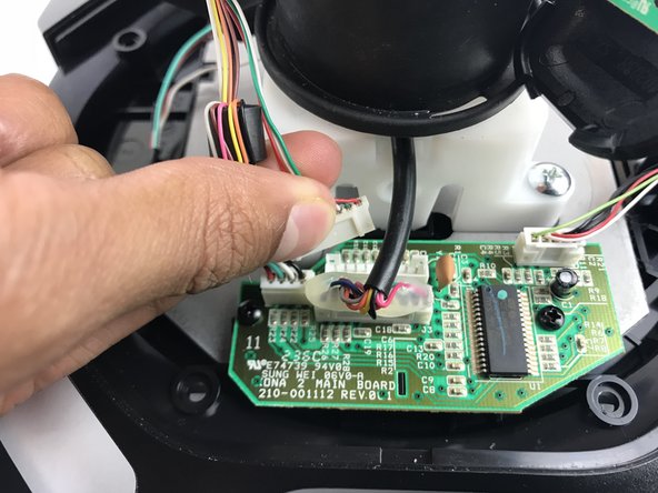

  6. Logitech Extreme 3D Pro Base Button Circuit Board Replacement, Base Button Circuit Board: crwdns2935265:06crwdnd2935265:01crwdnd2935265:02crwdne2935265:0 Logitech Extreme 3D Pro Base Button Circuit Board Replacement, Base Button Circuit Board: crwdns2935265:06crwdnd2935265:02crwdnd2935265:02crwdne2935265:0
    • Remove this wire plug head from this circuit board.
    • Removing this wire frees the base piece to make working on it easier.

    • Lift up the button board.
    • Disconnect the button board.
