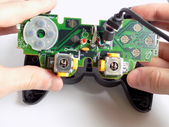

    • To get into the controller, you will need to unscrew the 7 screws on the back.
    • You will have to remove the bottom oval sticker to reveal the screw circled in red.
  2. Logitech Dual Action Triggers Repair: crwdns2935265:02crwdnd2935265:01crwdnd2935265:02crwdne2935265:0 Logitech Dual Action Triggers Repair: crwdns2935265:02crwdnd2935265:02crwdnd2935265:02crwdne2935265:0
    • With the screws removed, turn the controller upside down and separate the front end from the back end.
    • It is likely that the buttons will fall out of place, so as you open the controller, try to keep track of where the pieces go.
  3. Logitech Dual Action Triggers Repair: crwdns2935265:03crwdnd2935265:01crwdnd2935265:01crwdne2935265:0
    • There should be 4 circular buttons labeled 1-4, 4 smaller circular buttons for the D-Pad, and 3 oval shaped buttons.
  4. Logitech Dual Action Triggers Repair: crwdns2935265:04crwdnd2935265:01crwdnd2935265:03crwdne2935265:0 Logitech Dual Action Triggers Repair: crwdns2935265:04crwdnd2935265:02crwdnd2935265:03crwdne2935265:0 Logitech Dual Action Triggers Repair: crwdns2935265:04crwdnd2935265:03crwdnd2935265:03crwdne2935265:0
    • In the center of the controller, pull upwards on the USB cord.
    • Be careful not to pull hard enough to yank the wires connecting to the logic board.
    • With the wire out of the way, remove the screw it exposed. This will disconnect the logic board from the controller.
  5. Logitech Dual Action Triggers Repair: crwdns2935265:05crwdnd2935265:01crwdnd2935265:03crwdne2935265:0 Logitech Dual Action Triggers Repair: crwdns2935265:05crwdnd2935265:02crwdnd2935265:03crwdne2935265:0 Logitech Dual Action Triggers Repair: crwdns2935265:05crwdnd2935265:03crwdnd2935265:03crwdne2935265:0
    • To remove the triggers, push upwards from the back on them.
    • Once far enough, detach the logic board from the back cover piece and the triggers.

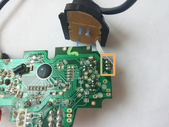

  6. Logitech Dual Action Triggers Repair: crwdns2935265:06crwdnd2935265:01crwdnd2935265:02crwdne2935265:0 Logitech Dual Action Triggers Repair: crwdns2935265:06crwdnd2935265:02crwdnd2935265:02crwdne2935265:0
    • If the wire is unplugged solely from the logic board, you can fasten it back into its place.
    • Look at the second picture to see where the wires go.
  7. Logitech Dual Action Triggers Repair: crwdns2935265:07crwdnd2935265:01crwdnd2935265:03crwdne2935265:0 Logitech Dual Action Triggers Repair: crwdns2935265:07crwdnd2935265:02crwdnd2935265:03crwdne2935265:0 Logitech Dual Action Triggers Repair: crwdns2935265:07crwdnd2935265:03crwdnd2935265:03crwdne2935265:0
    • Unscrew the screw on the trigger to remove the back cover.
    • Once removed, carefully pull the back cover off.
  8. Logitech Dual Action Triggers Repair: crwdns2935265:08crwdnd2935265:01crwdnd2935265:01crwdne2935265:0
    • The 3 wires are soldered into the 3 spots circled on the picture.
    • You can now fasten the wire into the right spot on the trigger piece.
