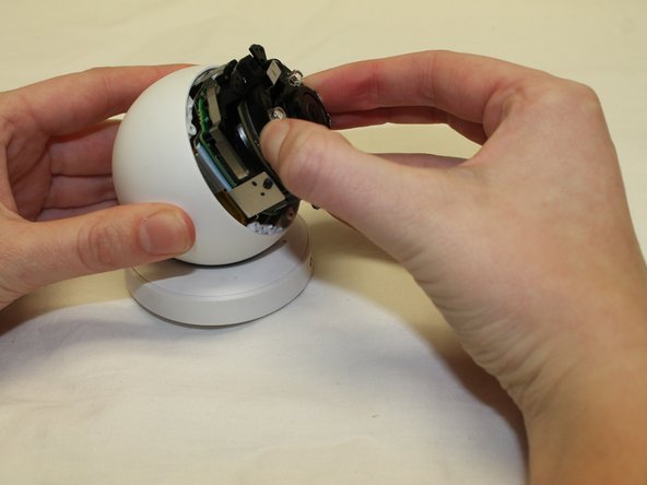

    • Finally, remove the last set of screws to access the inner parts of the circle.
    • Gently pull out the lens/battery assemble -- it's attached to a flexible ribbon cable that can rip, so be especially careful.

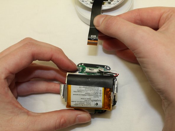

  5. Logitech Circle Teardown, Inside the Ball: crwdns2935265:05crwdnd2935265:01crwdnd2935265:02crwdne2935265:0 Logitech Circle Teardown, Inside the Ball: crwdns2935265:05crwdnd2935265:02crwdnd2935265:02crwdne2935265:0
    • Take care not to damage the flexible cable. On the connector, flip up the black plastic cam to release the cable. You can then remove the camera / battery assembly from the ball.
    • Note the extensive use of heat sinks and thermal interface (TIM) materials. This camera is delicately balanced thermally.

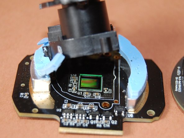

  7. Logitech Circle Teardown, Optical Chain: crwdns2935265:07crwdnd2935265:01crwdnd2935265:02crwdne2935265:0 Logitech Circle Teardown, Optical Chain: crwdns2935265:07crwdnd2935265:02crwdnd2935265:02crwdne2935265:0
    • The outer ring has lenses to focus IR light, and a hole for the camera lens.
    • The six infrared LEDs are on a thick board, with an aluminum heat spreader, and a connection to two solid metal blocks attached to the sensor board.
    • The lens is manually focused and secured with what looks like hot melt glue (this may cause focus issues over time).
    • There is just one piece of filter glass, flipped in place for day mode (higher end cameras use separate glass for day and night mode).
    • The optical sensor is at the bottom of the stack. It's surrounded by a clear plastic sticker (if you know why, post in the comments!).

any ideas where get a replacement ribbon cable? I dropped the camera when opening the box and the base and camera separated (ribbon cable tore). I was able to disassemble with this guide, but now I need a new cable and Logitech is no help (I asked).
Thanks
David
David Ludder - crwdns2934203:0crwdne2934203:0
We just had it fall off the table it was on and it did exactly the same thing... the base and camera separated (ribbon cable tore).
bradowenco -
I emailed the manufacturer of the cable to see if they can help, will let you know if they answer.
Nothing yet, I'll have to send another email.
