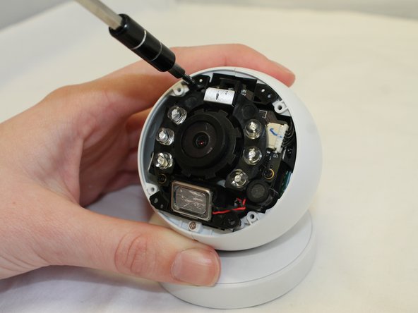

  4. Logitech Circle Speaker Replacement: crwdns2935265:04crwdnd2935265:01crwdnd2935265:02crwdne2935265:0 Logitech Circle Speaker Replacement: crwdns2935265:04crwdnd2935265:02crwdnd2935265:02crwdne2935265:0
    • Remove the four 3mm Phillips #0 screws that hold down the final ring. Do not remove the lens/battery bundle yet.
    • The lens/battery bundle is attached to the base by a ribbon cable that can break, so be very careful handling the circle.

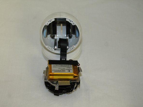

  5. Logitech Circle Speaker Replacement: crwdns2935265:05crwdnd2935265:01crwdnd2935265:02crwdne2935265:0 Logitech Circle Speaker Replacement: crwdns2935265:05crwdnd2935265:02crwdnd2935265:02crwdne2935265:0
    • Gently remove the lens/battery bundle from the base of the circle, being mindful of the ribbon cable.

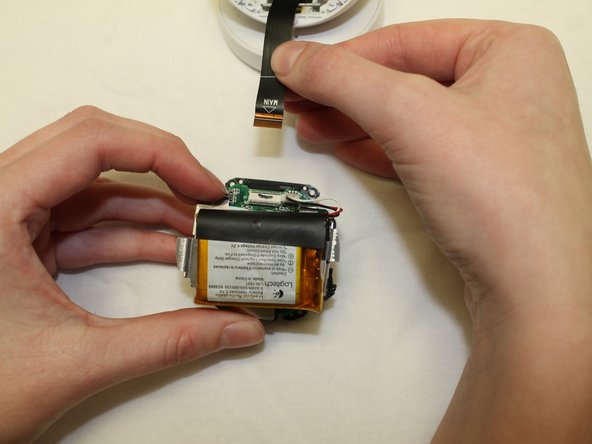

  6. Logitech Circle Speaker Replacement: crwdns2935265:06crwdnd2935265:01crwdnd2935265:02crwdne2935265:0 Logitech Circle Speaker Replacement: crwdns2935265:06crwdnd2935265:02crwdnd2935265:02crwdne2935265:0
    • Gently pull the ribbon cable loose from the lens/battery bundle.
    • While this is not an entirely necessary step, it helps to ensure the ribbon cable will not break during the rest of the replacement.
