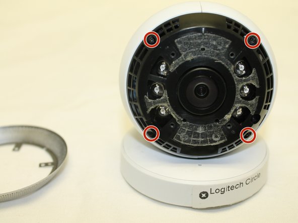

This guide will allow you to remove and replace the ribbon inside of the Logitech Circle. This guide is a bit more involved, as there are several screws that need to be removed and you will need to puncture the base of the Logitech in order to remove the cable. Be sure to keep the screws organized for easier reconstruction.

    2. Logitech Circle Ribbon Cable Replacement: crwdns2935265:02crwdnd2935265:01crwdnd2935265:02crwdne2935265:0 Logitech Circle Ribbon Cable Replacement: crwdns2935265:02crwdnd2935265:02crwdnd2935265:02crwdne2935265:0

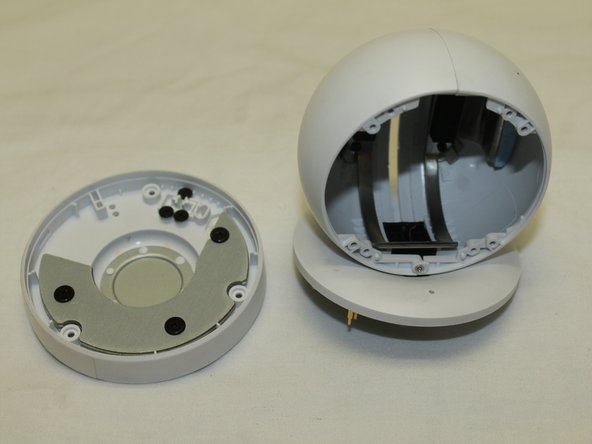

      • Remove the four 3mm Phillips #0 screws that hold down the first ring.
    3. Logitech Circle Ribbon Cable Replacement: crwdns2935265:03crwdnd2935265:01crwdnd2935265:02crwdne2935265:0 Logitech Circle Ribbon Cable Replacement: crwdns2935265:03crwdnd2935265:02crwdnd2935265:02crwdne2935265:0
      • Remove the four 3mm Phillips #0 screws that hold down the second ring.
    4. Logitech Circle Ribbon Cable Replacement: crwdns2935265:04crwdnd2935265:01crwdnd2935265:02crwdne2935265:0 Logitech Circle Ribbon Cable Replacement: crwdns2935265:04crwdnd2935265:02crwdnd2935265:02crwdne2935265:0
      • Remove the four 3mm Phillips #0 screws that hold down the final ring. Do not remove the lens/battery bundle yet.
      • The lens/battery bundle is attached to the base by a ribbon cable that can break, so be very careful handling the circle.

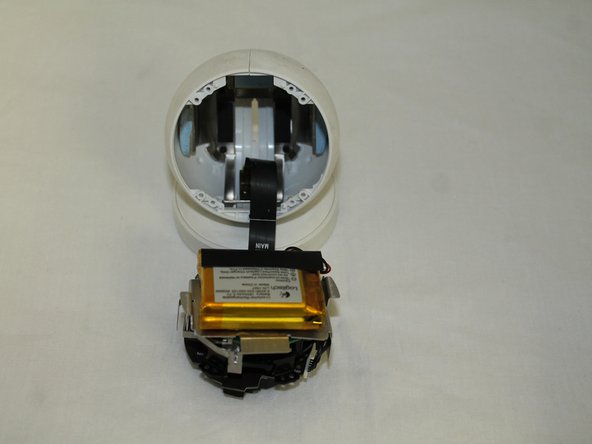

    5. Logitech Circle Ribbon Cable Replacement: crwdns2935265:05crwdnd2935265:01crwdnd2935265:02crwdne2935265:0 Logitech Circle Ribbon Cable Replacement: crwdns2935265:05crwdnd2935265:02crwdnd2935265:02crwdne2935265:0
      • Gently remove the lens/battery bundle from the base of the circle, being mindful of the ribbon cable.

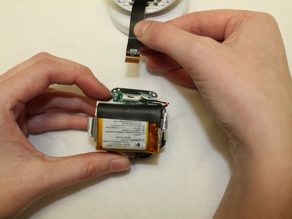

    6. Logitech Circle Ribbon Cable Replacement: crwdns2935265:06crwdnd2935265:01crwdnd2935265:02crwdne2935265:0 Logitech Circle Ribbon Cable Replacement: crwdns2935265:06crwdnd2935265:02crwdnd2935265:02crwdne2935265:0
      • Gently pull the ribbon cable loose from the lens/battery bundle.
      • While this is not an entirely necessary step, it helps to ensure the ribbon cable will not break during the rest of the replacement.

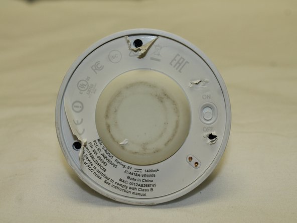

      • Once the old ribbon cable has been detached from the lens/battery bundle it's time to release the other side from the base.
      • Locate the screws holding the base together by feeling for the soft spots underneath the manufacturer's sticker. Punch through with your screwdriver and remove the three 3mm Phillips #0 screws.
      • The two pieces of the base can now be easily pulled apart.

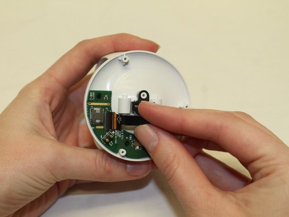

    8. Logitech Circle Ribbon Cable Replacement: crwdns2935265:08crwdnd2935265:01crwdnd2935265:02crwdne2935265:0 Logitech Circle Ribbon Cable Replacement: crwdns2935265:08crwdnd2935265:02crwdnd2935265:02crwdne2935265:0
      • Gently pull the ribbon cable loose from its connection to the base.
    9. Logitech Circle Ribbon Cable Replacement: crwdns2935265:09crwdnd2935265:01crwdnd2935265:02crwdne2935265:0 Logitech Circle Ribbon Cable Replacement: crwdns2935265:09crwdnd2935265:02crwdnd2935265:02crwdne2935265:0

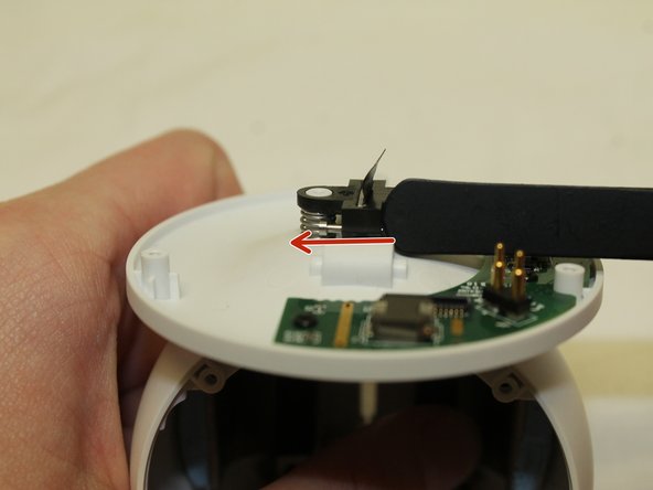

      • Slide the push pin holding the plastic connector/ribbon cable in place out on both sides.
    10. Logitech Circle Ribbon Cable Replacement: crwdns2935265:010crwdnd2935265:01crwdnd2935265:01crwdne2935265:0
