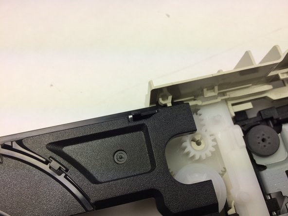

  8. Lite-On iHAS324 Disc Tray Belt Replacement, Disc Tray Belt: crwdns2935265:08crwdnd2935265:01crwdnd2935265:01crwdne2935265:0
    • Take tweezers and remove the black tray belt from the gears carefully.
