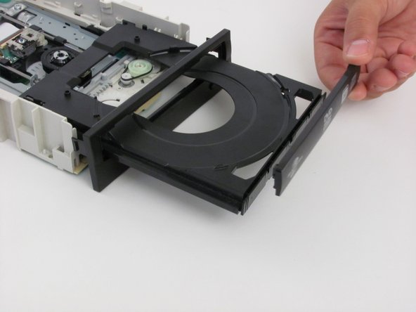

    • Insert an open paper clip into small hole on left side of faceplate.
    • The tray should click open, use your hands to gently extend it fully.
  2. Lite-On LightScribe SHM-165H6S Faceplate/Eject button Replacement: crwdns2935265:02crwdnd2935265:01crwdnd2935265:03crwdne2935265:0 Lite-On LightScribe SHM-165H6S Faceplate/Eject button Replacement: crwdns2935265:02crwdnd2935265:02crwdnd2935265:03crwdne2935265:0 Lite-On LightScribe SHM-165H6S Faceplate/Eject button Replacement: crwdns2935265:02crwdnd2935265:03crwdnd2935265:03crwdne2935265:0
    • Push in black tabs on left, right and bottom of outer chassis to unhook faceplate.
  3. Lite-On LightScribe SHM-165H6S Faceplate/Eject button Replacement: crwdns2935265:03crwdnd2935265:01crwdnd2935265:01crwdne2935265:0
    • Pull face plate away from main chassis.

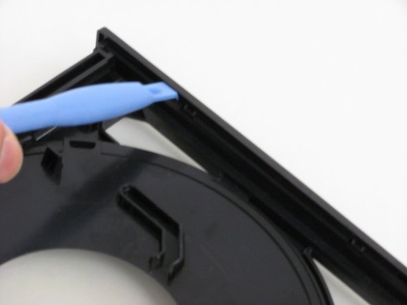

  4. Lite-On LightScribe SHM-165H6S Faceplate/Eject button Replacement: crwdns2935265:04crwdnd2935265:01crwdnd2935265:03crwdne2935265:0 Lite-On LightScribe SHM-165H6S Faceplate/Eject button Replacement: crwdns2935265:04crwdnd2935265:02crwdnd2935265:03crwdne2935265:0 Lite-On LightScribe SHM-165H6S Faceplate/Eject button Replacement: crwdns2935265:04crwdnd2935265:03crwdnd2935265:03crwdne2935265:0
    • Locate the two tabs on the underside of the tray cover.
    • Pry the tabs loose and remove cover.
  5. Lite-On LightScribe SHM-165H6S Faceplate/Eject button Replacement: crwdns2935265:05crwdnd2935265:01crwdnd2935265:01crwdne2935265:0
    • Remove and replace faceplate.
