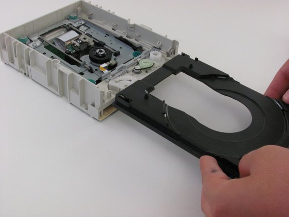

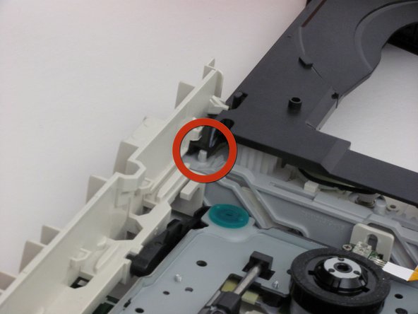

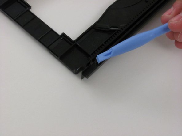

  6. Lite-On LightScribe SHM-165H6S Disc Tray Replacement, Disc Tray: crwdns2935265:06crwdnd2935265:01crwdnd2935265:03crwdne2935265:0 Lite-On LightScribe SHM-165H6S Disc Tray Replacement, Disc Tray: crwdns2935265:06crwdnd2935265:02crwdnd2935265:03crwdne2935265:0 Lite-On LightScribe SHM-165H6S Disc Tray Replacement, Disc Tray: crwdns2935265:06crwdnd2935265:03crwdnd2935265:03crwdne2935265:0
    • Extend the tray fully.
    • Push the tab on the right side to the left.
    • Push the tab on the left side to the left.
    • Remove the tray carefully.
  7. Lite-On LightScribe SHM-165H6S Disc Tray Replacement: crwdns2935265:07crwdnd2935265:01crwdnd2935265:03crwdne2935265:0 Lite-On LightScribe SHM-165H6S Disc Tray Replacement: crwdns2935265:07crwdnd2935265:02crwdnd2935265:03crwdne2935265:0 Lite-On LightScribe SHM-165H6S Disc Tray Replacement: crwdns2935265:07crwdnd2935265:03crwdnd2935265:03crwdne2935265:0
    • Guide the replacement tray under the beige tabs.
    • Make sure the grey piece is slid to the right, so the grey nob is under the right-hand groove of the tray.
    • Check to see that the tray extends and closes smoothly.
