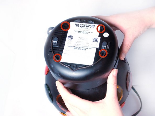

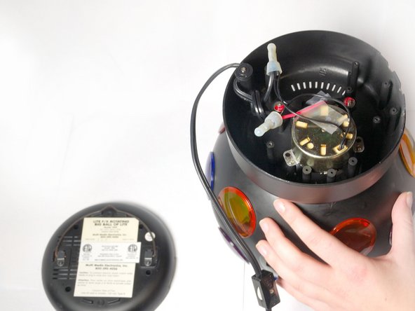

  3. Lite FX Rotating Big Ball of Lite Model 1929 Motor Replacement: crwdns2935265:03crwdnd2935265:01crwdnd2935265:02crwdne2935265:0 Lite FX Rotating Big Ball of Lite Model 1929 Motor Replacement: crwdns2935265:03crwdnd2935265:02crwdnd2935265:02crwdne2935265:0
    • Unscrew the four 10mm Phillips head screws on the bottom of the device.
    • Once the base is removed, the device should look as shown on the picture.

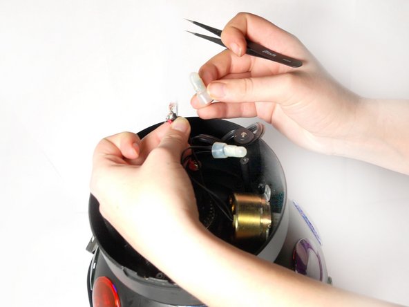

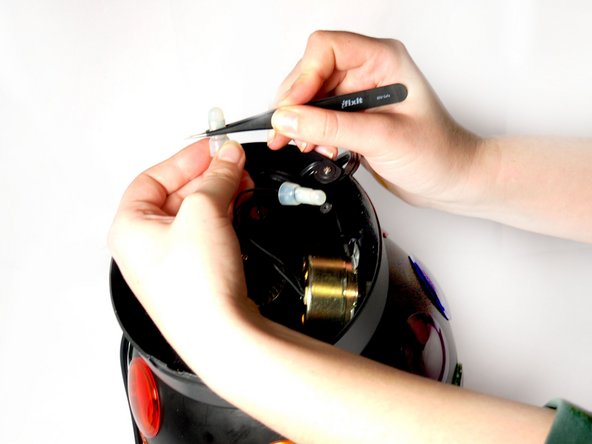

  4. Lite FX Rotating Big Ball of Lite Model 1929 Motor Replacement, Motor: crwdns2935265:04crwdnd2935265:01crwdnd2935265:02crwdne2935265:0 Lite FX Rotating Big Ball of Lite Model 1929 Motor Replacement, Motor: crwdns2935265:04crwdnd2935265:02crwdnd2935265:02crwdne2935265:0
    • Use a pair of tweezers to crush the sides of the wirenuts.
    • The wirenuts are crimped to lock the wires in place. Usually the wires are just twisted into them.
    • Pull all of the wires out of the wirenuts.
  5. Lite FX Rotating Big Ball of Lite Model 1929 Motor Replacement: crwdns2935265:05crwdnd2935265:01crwdnd2935265:02crwdne2935265:0 Lite FX Rotating Big Ball of Lite Model 1929 Motor Replacement: crwdns2935265:05crwdnd2935265:02crwdnd2935265:02crwdne2935265:0

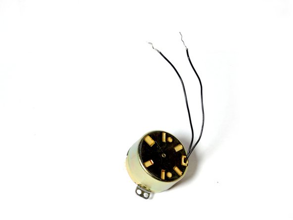

    • Separate the wires that belong to the motor.
    • The wires should be small and black.
    • Remove the motor.
