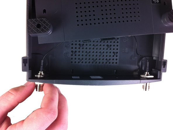

      • Unscrew the nut on the outer side of the back casing. Remove the nut and the washer from both antenna mounts.
    8. Liquid Damage Technique: crwdns2935265:08crwdnd2935265:01crwdnd2935265:02crwdne2935265:0 Liquid Damage Technique: crwdns2935265:08crwdnd2935265:02crwdnd2935265:02crwdne2935265:0
      • From here, remove the wires and nuts connected to the back panel by pulling the nuts through the holes.
      • Now the top casing has been removed and isolated from the rest of the device. From here, you can make repairs to the top casing.
