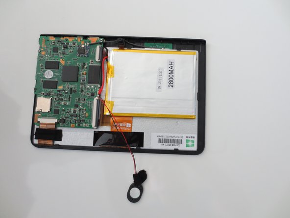

After determining that your battery is permanently damaged or broken, you can replace it with a new one.
    1. Linsay Model F-7HD2CORE Battery Replacement, Battery: crwdns2935265:01crwdnd2935265:01crwdnd2935265:03crwdne2935265:0 Linsay Model F-7HD2CORE Battery Replacement, Battery: crwdns2935265:01crwdnd2935265:02crwdnd2935265:03crwdne2935265:0 Linsay Model F-7HD2CORE Battery Replacement, Battery: crwdns2935265:01crwdnd2935265:03crwdnd2935265:03crwdne2935265:0
      • Carefully insert your plastic opening tool in between the white and black sections of your device.
      • Gently pry the top screen portion from the base of the tablet.
      • Your tablet should now look like the third image.
    2. Linsay Model F-7HD2CORE Battery Replacement: crwdns2935265:02crwdnd2935265:01crwdnd2935265:02crwdne2935265:0 Linsay Model F-7HD2CORE Battery Replacement: crwdns2935265:02crwdnd2935265:02crwdnd2935265:02crwdne2935265:0
      • To completely remove the base from the top of the tablet, peel the microphone from the back.
    3. Linsay Model F-7HD2CORE Battery Replacement: crwdns2935265:03crwdnd2935265:01crwdnd2935265:02crwdne2935265:0 Linsay Model F-7HD2CORE Battery Replacement: crwdns2935265:03crwdnd2935265:02crwdnd2935265:02crwdne2935265:0
      • Remove the two pieces of tape holding the battery in place by gently peeling it off.
    4. Linsay Model F-7HD2CORE Battery Replacement: crwdns2935265:04crwdnd2935265:01crwdnd2935265:01crwdne2935265:0
      • Using the spudger, carefully peel the battery off of the tablet panel.
      • Tape of the back of the battery will be very strong, pull gently!
      • The metal exterior of the battery can be quite pliable. Use caution when removing the battery from the tablet.
    5. Linsay Model F-7HD2CORE Battery Replacement: crwdns2935265:05crwdnd2935265:01crwdnd2935265:01crwdne2935265:0
      • To remove the battery, completely desolder the wires connected to the circuit board.
      • To reattach the new battery, you must solder the wires back on.
