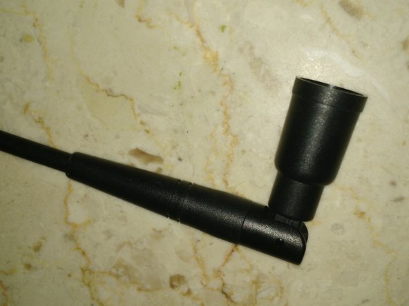

    • Begin by twisting the two antennas off.
    • They will come off as a whole assembly, see picture 2.

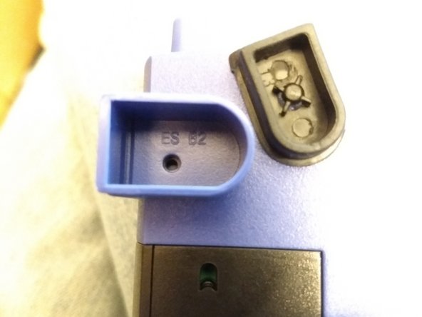

    • Remove two rubber feet from the front/blue section
    • If screws are present, remove them. (This WRT54GL v 1.1 shown did not have screws, but some of the many similar models do)

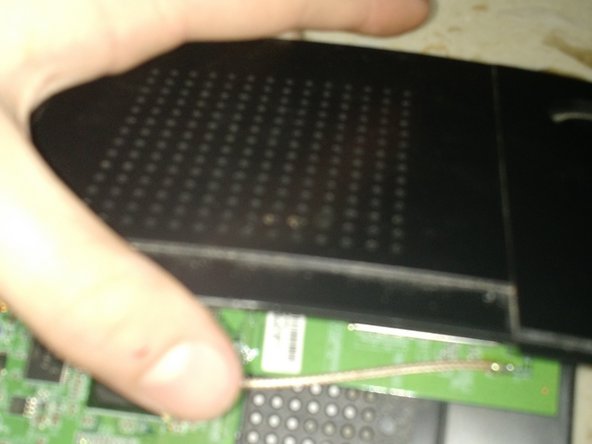

    • Place your thumbs into the two grooves near the back.
    • Place your index fingers in front of the back two legs.
    • Push the black top away.
    • Lift off the top cover.

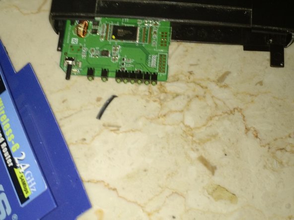

    • Using a Phillips head screwdrivers, remove the two screws in the middle of the motherboard.
  8. Linksys WRT54GL Teardown: crwdns2935265:08crwdnd2935265:01crwdnd2935265:01crwdne2935265:0
    • Place the middle section of your index fingers behind the two legs.
    • Place your thumbs on the ends of the antenna connection.
    • Apply very light force to remove the motherboard.
    • Lift the motherboard out of the shell.

“This may require considerable force.”
Or, pry out the two front feet, and remove the two hidden screws.
Less effort, less damage.
Steven Schweda - crwdns2934203:0crwdne2934203:0
Steven, which model and revision of router do you have? None of my WRT54GL v1.1 units have screws under the rubber feet, though there are holes to accomodate them. The front comes off without damage. The squeeze and pull did take some force, as I was disengaging two large clips (one on each side of the router.) I think step should be “remove the front rubber feet and remove screws (if present.)” This would help prevent damage and frustration with the great many very similar routers that may have screws.

You broke the right tab on the black part. (It even can be seen in the picture, the semicurcular part that lies on the table.) It will never hold the blue front as it should. Yes, that is the “needs consiserable force”.
