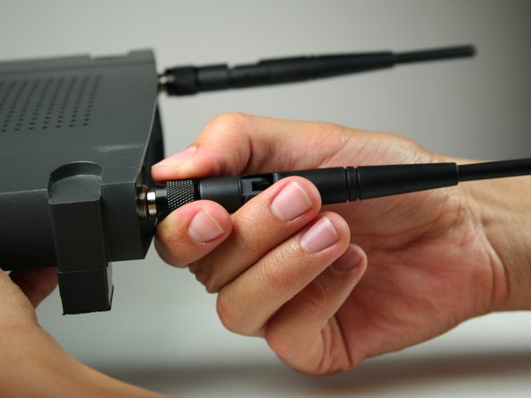

    • Unfold the antennas straight away from the device.

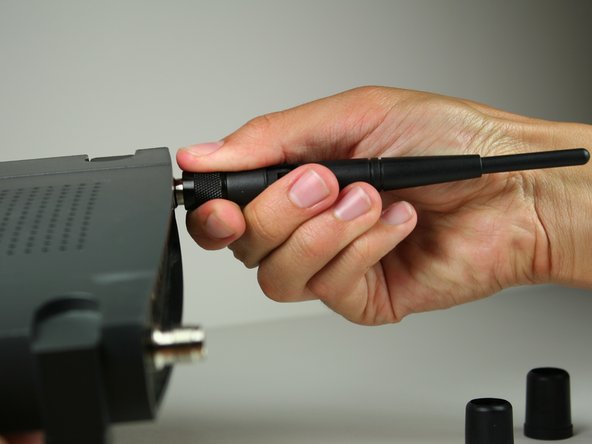

  2. Linksys WRT54G Motherboard Replacement: crwdns2935265:02crwdnd2935265:01crwdnd2935265:03crwdne2935265:0 Linksys WRT54G Motherboard Replacement: crwdns2935265:02crwdnd2935265:02crwdnd2935265:03crwdne2935265:0 Linksys WRT54G Motherboard Replacement: crwdns2935265:02crwdnd2935265:03crwdnd2935265:03crwdne2935265:0
    • Remove the black caps from the antennas by pulling them away from the device.

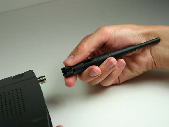

  3. Linksys WRT54G Motherboard Replacement: crwdns2935265:03crwdnd2935265:01crwdnd2935265:03crwdne2935265:0 Linksys WRT54G Motherboard Replacement: crwdns2935265:03crwdnd2935265:02crwdnd2935265:03crwdne2935265:0 Linksys WRT54G Motherboard Replacement: crwdns2935265:03crwdnd2935265:03crwdnd2935265:03crwdne2935265:0
    • Unscrew each of the antennas from the wireless device.

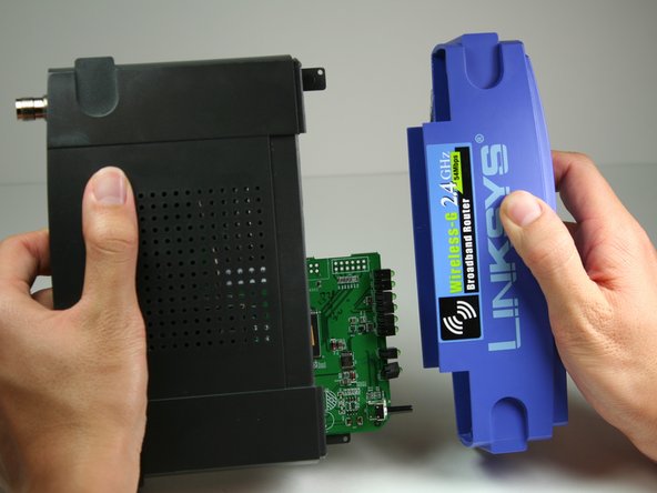

  4. Linksys WRT54G Motherboard Replacement, Casing: crwdns2935265:04crwdnd2935265:01crwdnd2935265:02crwdne2935265:0 Linksys WRT54G Motherboard Replacement, Casing: crwdns2935265:04crwdnd2935265:02crwdnd2935265:02crwdne2935265:0
    • Using a bit of force, remove the blue plastic case.

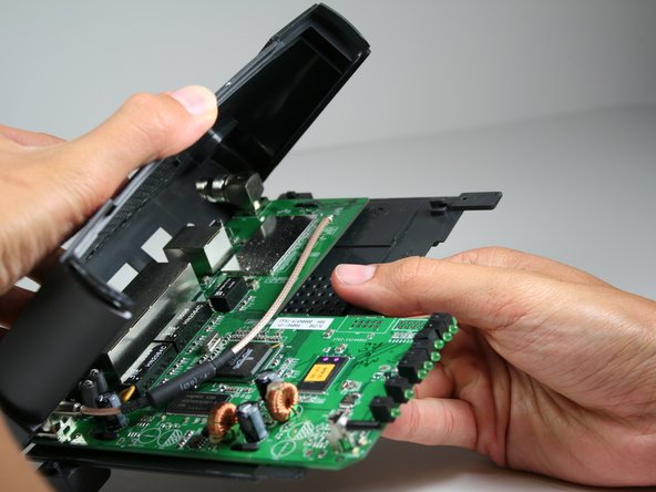

  5. Linksys WRT54G Motherboard Replacement, Motherboard: crwdns2935265:05crwdnd2935265:01crwdnd2935265:02crwdne2935265:0 Linksys WRT54G Motherboard Replacement, Motherboard: crwdns2935265:05crwdnd2935265:02crwdnd2935265:02crwdne2935265:0
    • To remove the black casing that surrounds the green motherboard, slide the top half of the casing backwards. It only moves a very short distance.
    • Pull the top piece upwards and away from the bottom to remove.

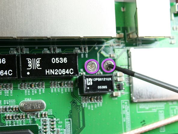

  6. Linksys WRT54G Motherboard Replacement: crwdns2935265:06crwdnd2935265:01crwdnd2935265:02crwdne2935265:0 Linksys WRT54G Motherboard Replacement: crwdns2935265:06crwdnd2935265:02crwdnd2935265:02crwdne2935265:0
    • Locate the 2 M2.5x6mm screws that attach the motherboard to the back case.
    • Remove the two screws from the motherboard as indicated with the Phillips head screwdriver.
