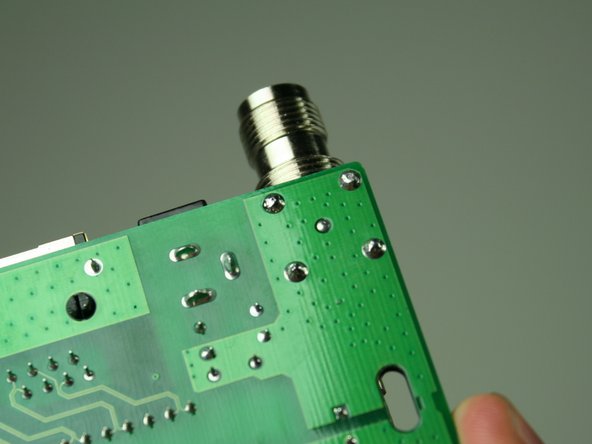

  8. Linksys WRT54G Motherboard Component Replacement, Motherboard Component: crwdns2935265:08crwdnd2935265:01crwdnd2935265:01crwdne2935265:0
    • Obtain a desoldering wick (Desoldering Braid). Plug in soldering iron and allow to heat. For soldering information, refer to the iFixit soldering guide (How To Solder and Desolder Connections).
    • Make sure that the soldering iron is not resting on top of anything that would be damaged by the heat.
  9. Linksys WRT54G Motherboard Component Replacement: crwdns2935265:09crwdnd2935265:01crwdnd2935265:02crwdne2935265:0 Linksys WRT54G Motherboard Component Replacement: crwdns2935265:09crwdnd2935265:02crwdnd2935265:02crwdne2935265:0
    • Identify the functional component which will be removed.
    • Turn the board over so that the pins holding the component in are exposed.
  10. Linksys WRT54G Motherboard Component Replacement: crwdns2935265:010crwdnd2935265:01crwdnd2935265:01crwdne2935265:0
