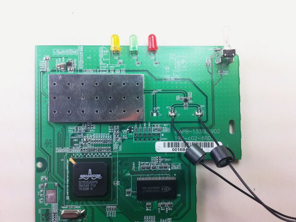

You will start by isolating the motherboard and then continue to make the suggested repairs by soldering.
    1. Linksys WAP54g LED Lights Replacement, Top Casing: crwdns2935265:01crwdnd2935265:01crwdnd2935265:01crwdne2935265:0
      • Power down and unplug the device.
    2. Linksys WAP54g LED Lights Replacement: crwdns2935265:02crwdnd2935265:01crwdnd2935265:01crwdne2935265:0
    3. Linksys WAP54g LED Lights Replacement: crwdns2935265:03crwdnd2935265:01crwdnd2935265:01crwdne2935265:0
      • Remove the two black rubber feet of the device using the screwdriver. The feet are located on the bottom towards the front.
    4. Linksys WAP54g LED Lights Replacement: crwdns2935265:04crwdnd2935265:01crwdnd2935265:01crwdne2935265:0
      • Once the feet are removed, two small screws will be visible. With a small screwdriver, unscrew them. Screws are phillips head, 4.35 mm in diameter, 7.88 mm in length.
    5. Linksys WAP54g LED Lights Replacement: crwdns2935265:05crwdnd2935265:01crwdnd2935265:01crwdne2935265:0
      • To remove the front blue panel, grip firmly and place thumbs in the two notches on top. Push thumbs forward while keeping a firm grip on bottom.
      • This may require a bit of force.
    6. Linksys WAP54g LED Lights Replacement: crwdns2935265:06crwdnd2935265:01crwdnd2935265:01crwdne2935265:0
      • Now slide the bottom panel forward and remove it so the top casing is isolated from the bottom casing and motherboard.
    7. Linksys WAP54g LED Lights Replacement: crwdns2935265:07crwdnd2935265:01crwdnd2935265:02crwdne2935265:0 Linksys WAP54g LED Lights Replacement: crwdns2935265:07crwdnd2935265:02crwdnd2935265:02crwdne2935265:0
      • Unscrew the nut on the outer side of the back casing. Remove the nut and the washer from both antenna mounts.
    8. Linksys WAP54g LED Lights Replacement: crwdns2935265:08crwdnd2935265:01crwdnd2935265:02crwdne2935265:0 Linksys WAP54g LED Lights Replacement: crwdns2935265:08crwdnd2935265:02crwdnd2935265:02crwdne2935265:0
      • From here, remove the wires and nuts connected to the back panel by pulling the nuts through the holes.
      • Now the top casing has been removed and isolated from the rest of the device. From here, you can make repairs to the top casing.
      • Once the top panel is removed the main board will still be attached to the bottom panel.
    1. Linksys WAP54g LED Lights Replacement, Bottom Casing/Motherboard: crwdns2935265:09crwdnd2935265:01crwdnd2935265:02crwdne2935265:0 Linksys WAP54g LED Lights Replacement, Bottom Casing/Motherboard: crwdns2935265:09crwdnd2935265:02crwdnd2935265:02crwdne2935265:0
      • Unscrew the two screws that connect the motherboard to the bottom casing.
      • The motherboard and bottom casing should be completely separated at this point. This allows for replacement of the motherboard and/ or its components as well as the bottom casing.
    1. Linksys WAP54g LED Lights Replacement, LED Lights: crwdns2935265:010crwdnd2935265:01crwdnd2935265:01crwdne2935265:0
      • Using a soldering iron, desolder the LED lights from the bottom of the logic board.
      • For help with soldering or desoldering refer to ifixit's soldering guide: How To Solder and Desolder Connections
    2. Linksys WAP54g LED Lights Replacement: crwdns2935265:011crwdnd2935265:01crwdnd2935265:01crwdne2935265:0
      • Place new LED lights through holes created by desoldering and removing old lights.
    3. Linksys WAP54g LED Lights Replacement: crwdns2935265:012crwdnd2935265:01crwdnd2935265:02crwdne2935265:0 Linksys WAP54g LED Lights Replacement: crwdns2935265:012crwdnd2935265:02crwdnd2935265:02crwdne2935265:0
      • Solder the lights onto the bottom of the board to solidify the connection and make electrical contact.
      • Follow the Installing the Casing guide in reverse to re-assemble your device.
Once the soldering is complete, the device should work and the LED lights should light up.
