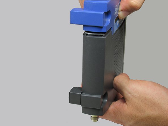

    • Using two hands, pull on the top and bottom sections to separate the blue and the black pieces.
    • This requires significant amount of force.
    • The seal is located where the blue plastic meets the black plastic. This is where you will apply pressure.
