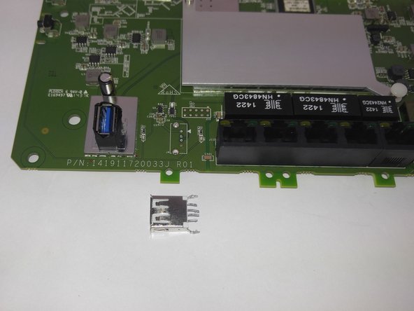

  6. Linksys EA9200 USB Port Replacement, USB Port: crwdns2935265:06crwdnd2935265:01crwdnd2935265:02crwdne2935265:0 Linksys EA9200 USB Port Replacement, USB Port: crwdns2935265:06crwdnd2935265:02crwdnd2935265:02crwdne2935265:0
    • Desolder the 6 pin points fully.
    • How To Solder and Desolder Connections is iFixit's official guide on how to use a soldering iron.
    • You will need a soldering iron that is capable of reaching temperatures greater than 300 degrees Fahrenheit.
    • Temperature of the component will be very hot when desoldered, take precaution when handling.
