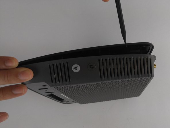

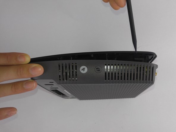

  3. Linksys EA9200 Power Switch Replacement: crwdns2935265:03crwdnd2935265:01crwdnd2935265:03crwdne2935265:0 Linksys EA9200 Power Switch Replacement: crwdns2935265:03crwdnd2935265:02crwdnd2935265:03crwdne2935265:0 Linksys EA9200 Power Switch Replacement: crwdns2935265:03crwdnd2935265:03crwdnd2935265:03crwdne2935265:0

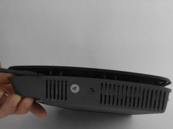

    • Depress the 12 clips along the edge into the router. Use the nylon spudger as using a metal object could cause damage.

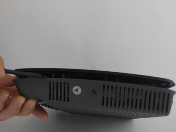

  4. Linksys EA9200 Power Switch Replacement: crwdns2935265:04crwdnd2935265:01crwdnd2935265:03crwdne2935265:0 Linksys EA9200 Power Switch Replacement: crwdns2935265:04crwdnd2935265:02crwdnd2935265:03crwdne2935265:0 Linksys EA9200 Power Switch Replacement: crwdns2935265:04crwdnd2935265:03crwdnd2935265:03crwdne2935265:0
    • Once you have one side open, keep a spudger wedged between both sides. This will help keep it open in case it tries to snap back together.
    • These clips are tough and may need some additional force.

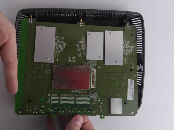

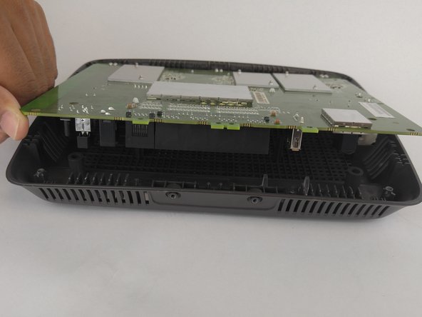

  5. Linksys EA9200 Power Switch Replacement: crwdns2935265:05crwdnd2935265:01crwdnd2935265:03crwdne2935265:0 Linksys EA9200 Power Switch Replacement: crwdns2935265:05crwdnd2935265:02crwdnd2935265:03crwdne2935265:0 Linksys EA9200 Power Switch Replacement: crwdns2935265:05crwdnd2935265:03crwdnd2935265:03crwdne2935265:0
    • Lift the board and pull down, away from the antennas.

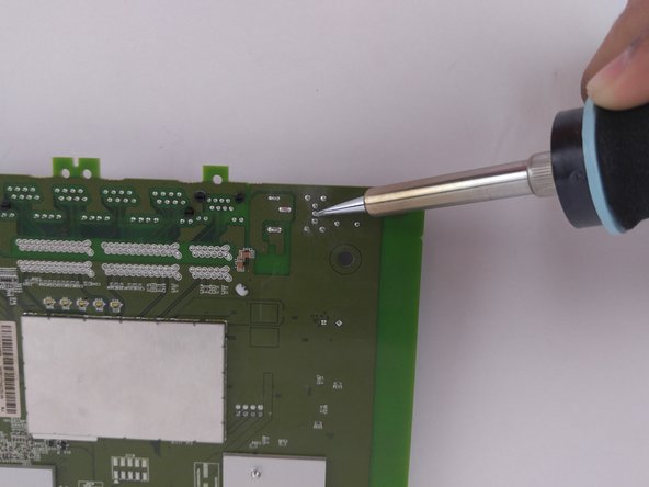

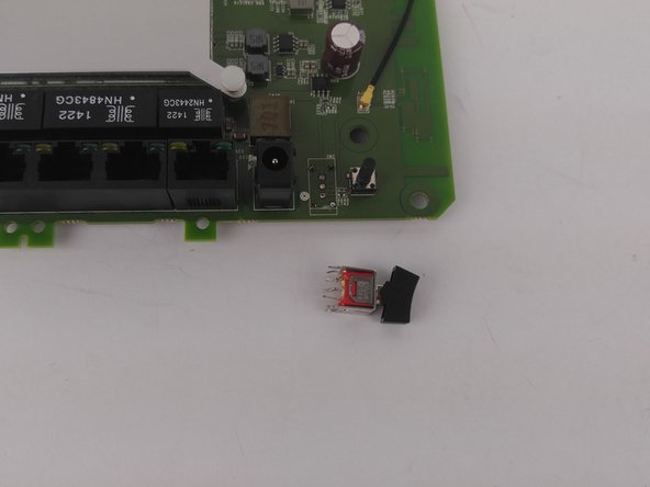

  6. Linksys EA9200 Power Switch Replacement, Power Switch: crwdns2935265:06crwdnd2935265:01crwdnd2935265:03crwdne2935265:0 Linksys EA9200 Power Switch Replacement, Power Switch: crwdns2935265:06crwdnd2935265:02crwdnd2935265:03crwdne2935265:0 Linksys EA9200 Power Switch Replacement, Power Switch: crwdns2935265:06crwdnd2935265:03crwdnd2935265:03crwdne2935265:0
    • Desolder the 7 pins for the power switch from the backside of the circuit board.
    • In order to remove this part you will need a soldering iron that is capable of reaching temperatures greater than 300 degrees Fahrenheit.
    • How To Solder and Desolder Connections is iFixit's official guide on how to use a soldering iron.
