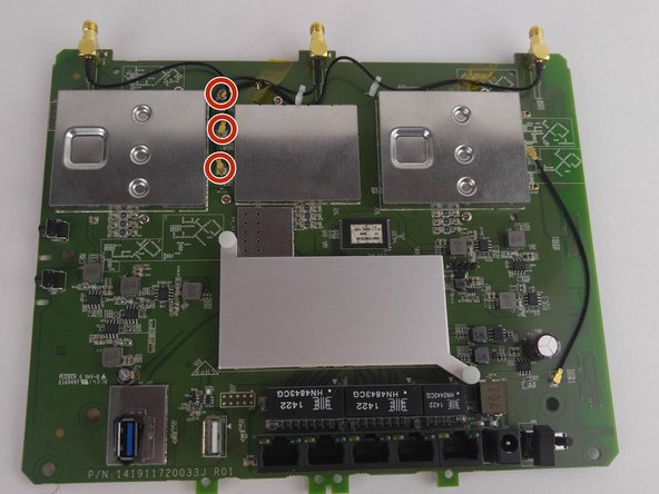

  5. Linksys EA9200 Antenna Port  Replacement: crwdns2935265:05crwdnd2935265:01crwdnd2935265:03crwdne2935265:0 Linksys EA9200 Antenna Port  Replacement: crwdns2935265:05crwdnd2935265:02crwdnd2935265:03crwdne2935265:0 Linksys EA9200 Antenna Port  Replacement: crwdns2935265:05crwdnd2935265:03crwdnd2935265:03crwdne2935265:0
    • Lift the board and pull down, away from the antennas.

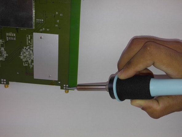

  6. Linksys EA9200 Antenna Port  Replacement, Antenna Port: crwdns2935265:06crwdnd2935265:01crwdnd2935265:02crwdne2935265:0 Linksys EA9200 Antenna Port  Replacement, Antenna Port: crwdns2935265:06crwdnd2935265:02crwdnd2935265:02crwdne2935265:0
    • The antenna ports are connected to the board with a wire that has a "snap" connector.
  7. Linksys EA9200 Antenna Port  Replacement: crwdns2935265:07crwdnd2935265:01crwdnd2935265:02crwdne2935265:0 Linksys EA9200 Antenna Port  Replacement: crwdns2935265:07crwdnd2935265:02crwdnd2935265:02crwdne2935265:0
    • Desolder the four pins of the antenna port.
    • Do not place the soldering iron on the wrong terminals as this can cause the device to no longer to function.
    • How To Solder and Desolder Connections is iFixit's official guide on how to use a soldering iron
    • You will need a soldering iron that is capable of reaching temperatures greater than 300 degrees Fahrenheit.
    • Temperature of the component will be very hot when desoldered, take precaution when handling.
  8. Linksys EA9200 Antenna Port  Replacement: crwdns2935265:08crwdnd2935265:01crwdnd2935265:01crwdne2935265:0
    • Once the solder is melted, quickly pull broken antenna port.
