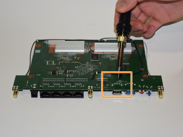

    • Locate the USB ports on both sides of the router motherboard. There are six points on the reverse side where the USB ports are soldered onto.
    • Apply the soldering iron carefully to the six points to melt to solder. Touching the motherboard with the solder can damage the circuits.
    • Be careful with using the soldering iron, it is hot!

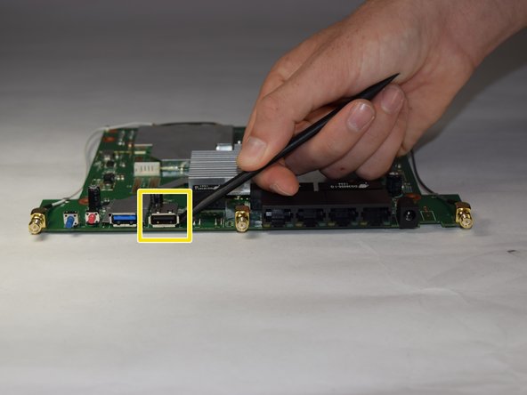

    • After the solder has melted and been removed, gently pry the USB port with a black spudger to separate it from the motherboard.
    • Confirm that all of the old solder has been removed after the USB port is detached from the motherboard.
