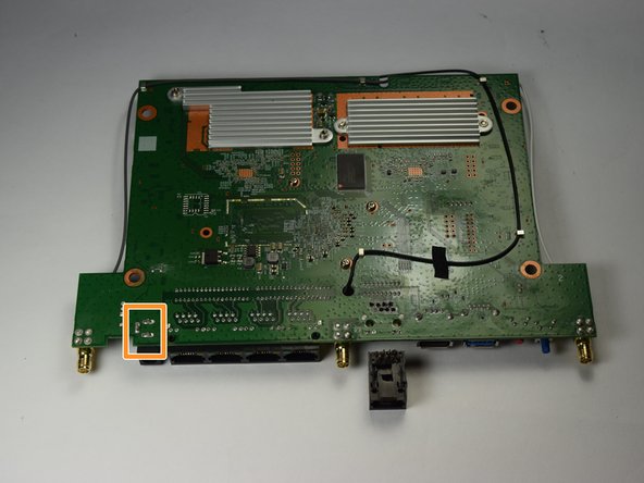

    • Locate the power port on both sides of the motherboard.
    • The power port on the top side is in a rectangular black casing.
    • Identify the three prongs where the power port is soldered to on the reverse side.

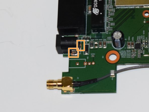

    • Carefully apply the soldering iron on each of the three points on the bottom side of the motherboard to melt them.
    • Be careful to not touch the motherboard with the soldering iron, you can damage the circuits.
    • After you have melted and removed the solder, flip the mother board around and identify the connecting points of the power port.

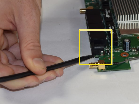

    • Use a black spudger to gently separate the power port from the motherboard
