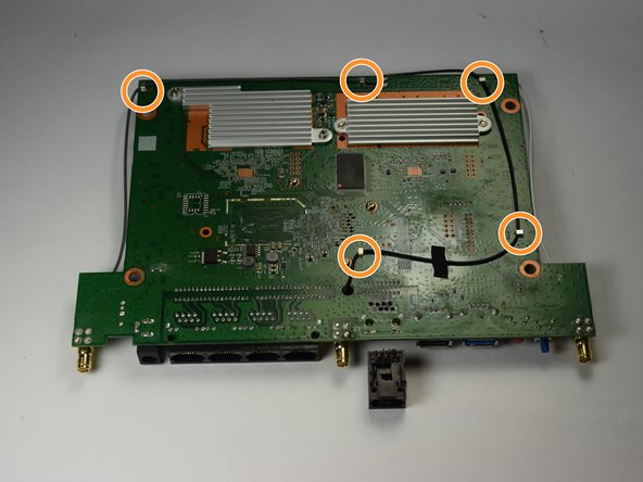

  4. Linksys EA6900 Antenna Replacement: crwdns2935265:04crwdnd2935265:01crwdnd2935265:03crwdne2935265:0 Linksys EA6900 Antenna Replacement: crwdns2935265:04crwdnd2935265:02crwdnd2935265:03crwdne2935265:0 Linksys EA6900 Antenna Replacement: crwdns2935265:04crwdnd2935265:03crwdnd2935265:03crwdne2935265:0
    • Gently lift the motherboard and remove it from the case
    • Put the motherboard over a (preferably white) surface.
  5. Linksys EA6900 Antenna Replacement, Antenna: crwdns2935265:05crwdnd2935265:01crwdnd2935265:02crwdne2935265:0 Linksys EA6900 Antenna Replacement, Antenna: crwdns2935265:05crwdnd2935265:02crwdnd2935265:02crwdne2935265:0
    • Detach the wires from the motherboard.
    • Flip the motherboard and repeat the process.

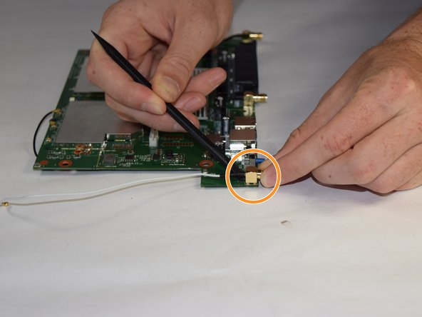

  6. Linksys EA6900 Antenna Replacement: crwdns2935265:06crwdnd2935265:01crwdnd2935265:02crwdne2935265:0 Linksys EA6900 Antenna Replacement: crwdns2935265:06crwdnd2935265:02crwdnd2935265:02crwdne2935265:0
    • Locate the four solder points on each port and melt them using a soldering iron.
    • Wait between five and seven minutes for the ports to cool down.
    • Remove each port using a nylon spudger
