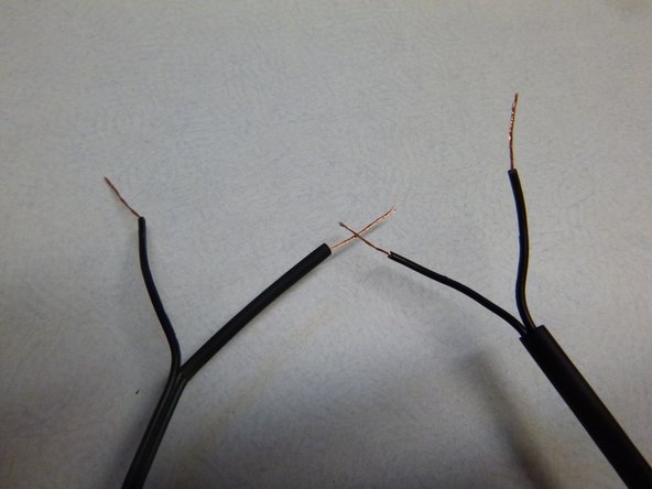

      • Begin by cutting the wire.
      • Strip the wire.
      • Seperate the two halves of each wire, and split the two with a utility knife. Don't go too far! You will need the extra space to overlay HeatShrink before the soldering is down.

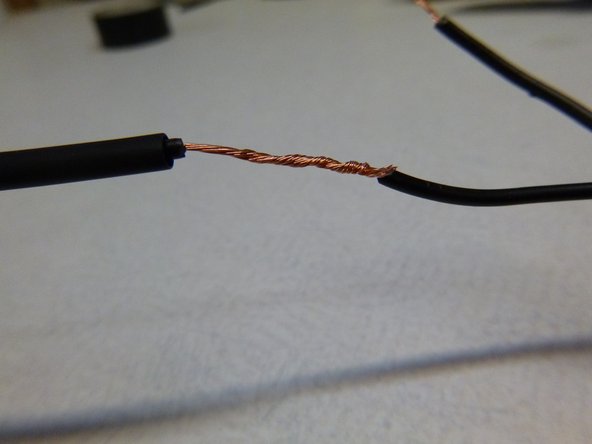

      • Twist the individual strands together to make a single pigtail.
      • Overlay with the corresponding wire (Step 1), and twist together, but not before sliding on the HeatShrink.

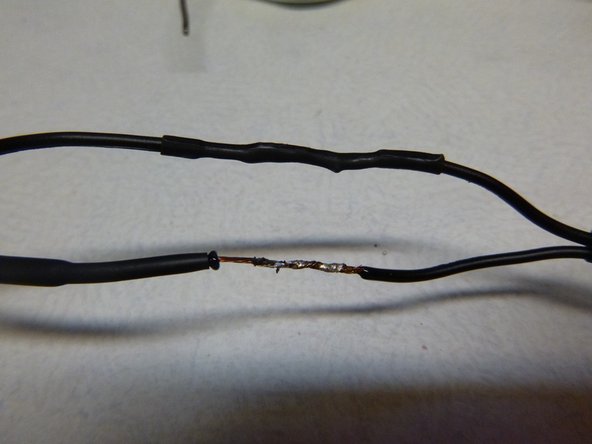

    4. Linksys E1200 Router Power Adapter Replacement: crwdns2935265:04crwdnd2935265:01crwdnd2935265:03crwdne2935265:0 Linksys E1200 Router Power Adapter Replacement: crwdns2935265:04crwdnd2935265:02crwdnd2935265:03crwdne2935265:0 Linksys E1200 Router Power Adapter Replacement: crwdns2935265:04crwdnd2935265:03crwdnd2935265:03crwdne2935265:0
      • Pull the wire seperation back far enough on at least one side to permit Heat-Shrink to slip over the wire insulation.

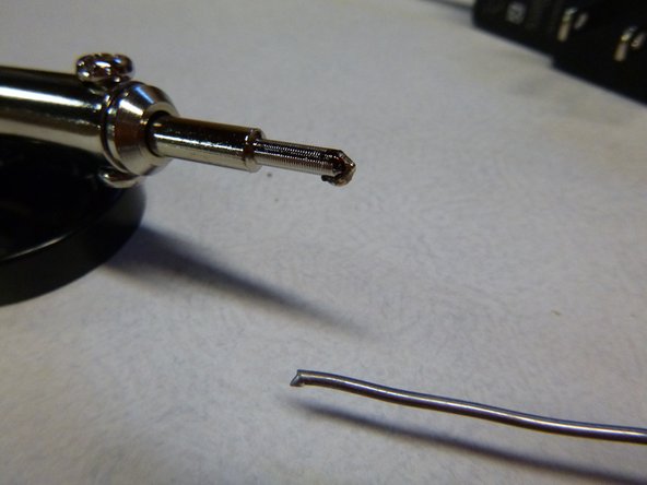

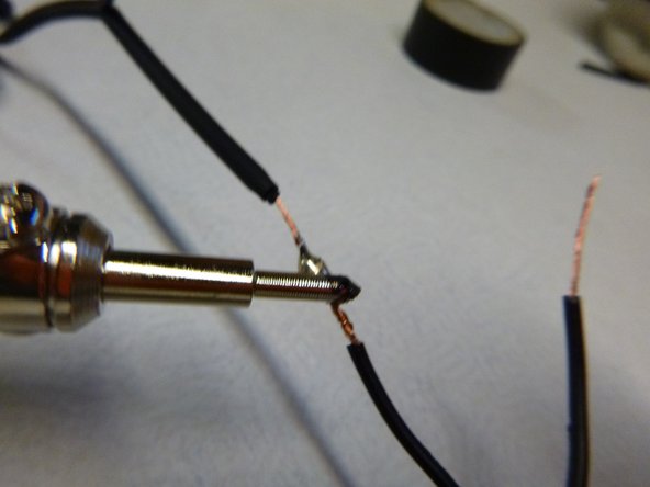

      • Now the soldering. Place the pre-heated iron on the wires on a heat-resistant, flame proof surface. Make sure that the Heat-Shrink is nowhere near the soldering iron.
      • Let it heat for a few sconds (copper is an excellent conductor of heat), then touch the end of the solder to the wire. If fully heated, it should flow easily into the joint.

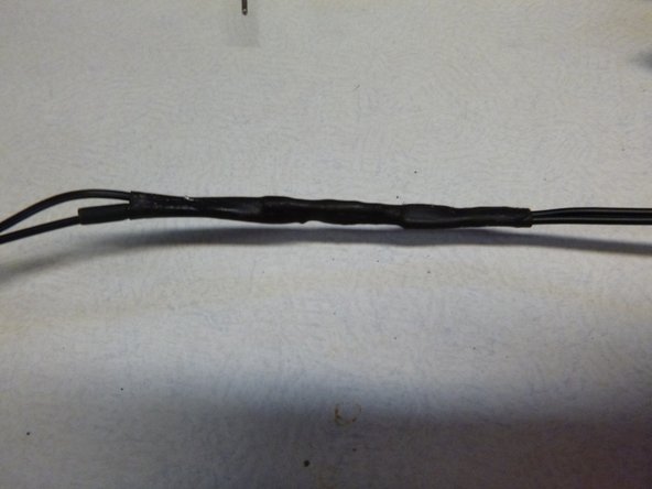

      • To protect the solder job, you will need to slide the shrink wrap over the patch, then heat it so that it grips the wire securely. You can use a heat gun or the flat side of a soldering iron. Be careful to not let it burn!
      • Repeat for the other wire. Repeat for the overall sheath.
