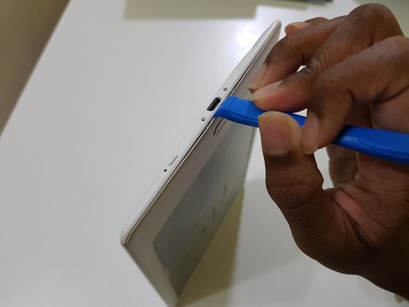

    • Use the opening tool to pry at the lip in between the bezel and rear cover,
    • then slide in your opening pick with the flat end,
    • and slide it around to undo these clips.

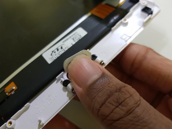

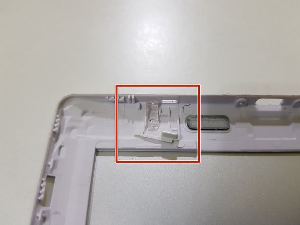

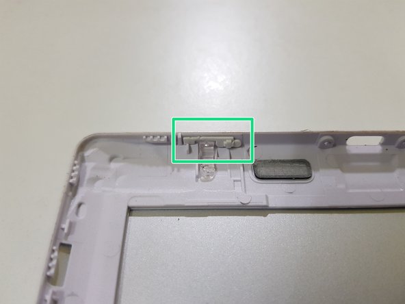

    • After releasing the clips, lift the front bezel out.
    • The extension piece for the power button can fall out. Don't lose this!

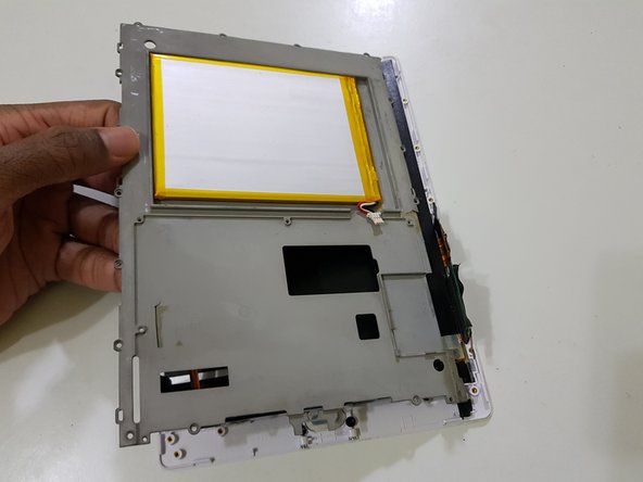

  5. Likebook Muses Display Replacement: crwdns2935265:05crwdnd2935265:01crwdnd2935265:01crwdne2935265:0
    • The rear cover has been removed.

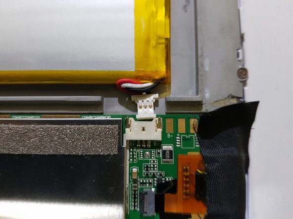

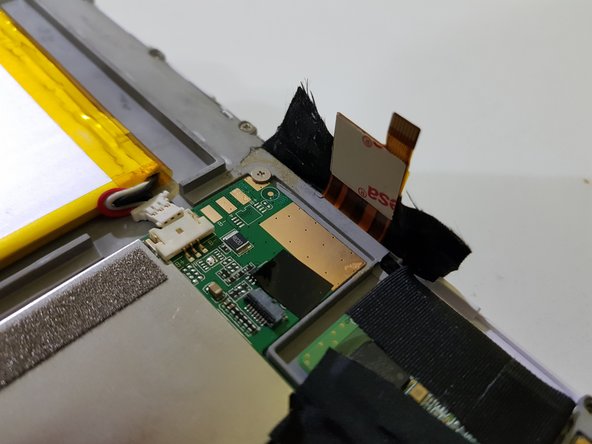

    • Disconnect the battery.
    • Due to the placement of the battery, the connector may not come out all the way.

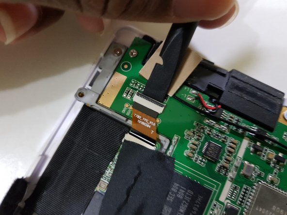

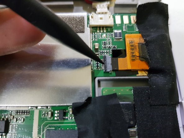

    • Using the pointed end of a spudger, disconnect the touch panel.

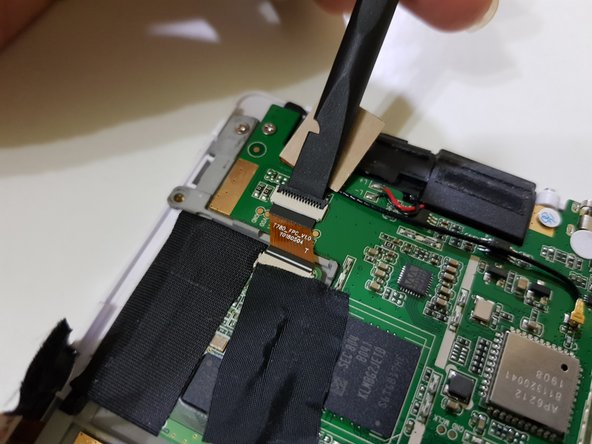

    • Disconnect the pen input controller.
  9. Likebook Muses Display Replacement: crwdns2935265:09crwdnd2935265:01crwdnd2935265:03crwdne2935265:0 Likebook Muses Display Replacement: crwdns2935265:09crwdnd2935265:02crwdnd2935265:03crwdne2935265:0 Likebook Muses Display Replacement: crwdns2935265:09crwdnd2935265:03crwdnd2935265:03crwdne2935265:0

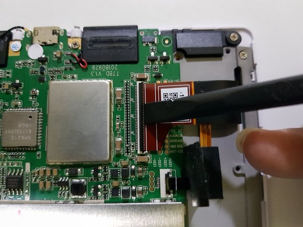

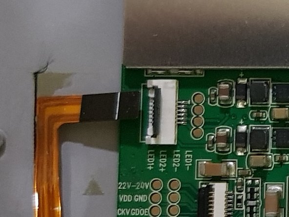

    • Lift up part of the tape covering the frontlight connector.
    • Using the flat end of your spudger, disconnect the display.
  10. Likebook Muses Display Replacement: crwdns2935265:010crwdnd2935265:01crwdnd2935265:02crwdne2935265:0 Likebook Muses Display Replacement: crwdns2935265:010crwdnd2935265:02crwdnd2935265:02crwdne2935265:0

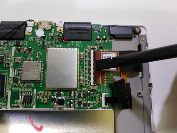

    • Peel the tape the rest of the way
    • Using the pointed end of your spudger, disconnect the frontlight.

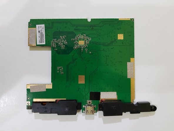

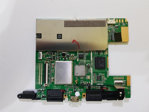

    • Lift the mainboard out from the top,
    • The speaker connections are only held in with solder, and may break if you're not careful.
  13. Likebook Muses Display Replacement: crwdns2935265:013crwdnd2935265:01crwdnd2935265:03crwdne2935265:0 Likebook Muses Display Replacement: crwdns2935265:013crwdnd2935265:02crwdnd2935265:03crwdne2935265:0 Likebook Muses Display Replacement: crwdns2935265:013crwdnd2935265:03crwdnd2935265:03crwdne2935265:0
    • The mainboard has been removed.

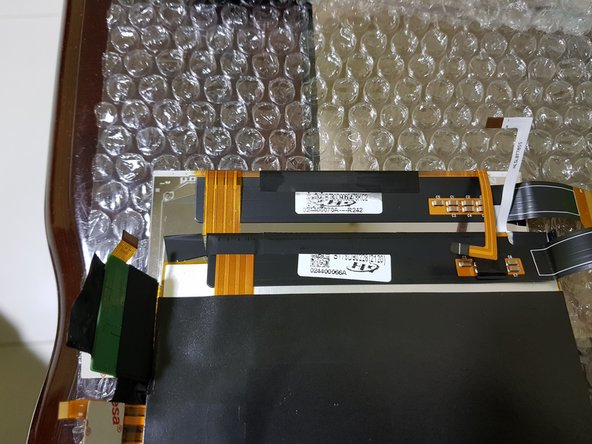

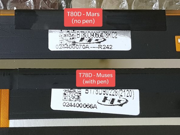

  17. Likebook Muses Display Replacement, If you received a Likebook Mars display: crwdns2935265:018crwdnd2935265:01crwdnd2935265:03crwdne2935265:0 Likebook Muses Display Replacement, If you received a Likebook Mars display: crwdns2935265:018crwdnd2935265:02crwdnd2935265:03crwdne2935265:0 Likebook Muses Display Replacement, If you received a Likebook Mars display: crwdns2935265:018crwdnd2935265:03crwdnd2935265:03crwdne2935265:0
    • Some sellers may send you a Likebook Mars display claiming that it's for the Likebook Muses.
    • If so, please contact the seller or read reviews/descriptions, which will most likely mention having to transplant the pen digitiser over.
    • This is where this guide goes from "difficult" to "very difficult".
    • Here's how to tell:
    • Shiny back instead of a black back
    • 3 connections instead of 4
    • "T80D" on the label on the back of the display, instead of "T78D"
    • The Likebook Mars (model T80D) is the predecessor to the Likebook Muses (model T78D), lacking pen input, and thus lacks a "Notes" tab on the Home screen's bottom navigation and a "Annotations" tab on the "Read" tab.
    • (placeholder: about testing the display)
    • If you want to, you can test the display to make sure that it's functioning before proceeding to pull away the display and touch cables, and transplanting the pen digitiser from the previous display.
    • You'll need a piece of paper large enough to prevent the EPD panel from rubbing up against the midframe and getting scratched.
    • Insert it between the midframe and display assembly.
    • Don't leave it running with the back cover removed for too long, as this can cause damage to the display controller, resulting in the display freezing and/or not being able to refresh properly.
    • You will need to peel the pen digitiser off the damaged EPD panel.
