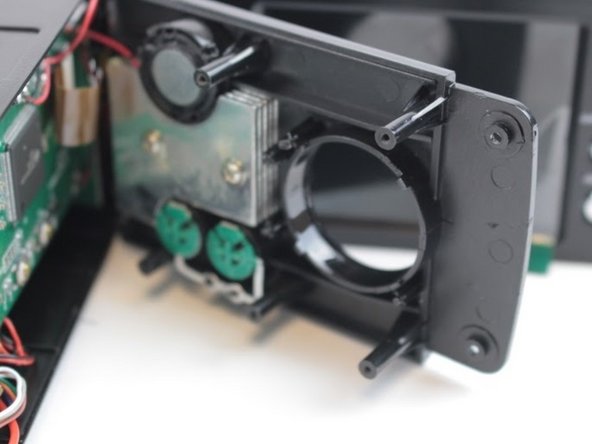

  2. Lightahead DV328 Arrow Button Replacement: crwdns2935265:02crwdnd2935265:01crwdnd2935265:03crwdne2935265:0 Lightahead DV328 Arrow Button Replacement: crwdns2935265:02crwdnd2935265:02crwdnd2935265:03crwdne2935265:0 Lightahead DV328 Arrow Button Replacement: crwdns2935265:02crwdnd2935265:03crwdnd2935265:03crwdne2935265:0
    • Once you are able to lift the cover up, you will then be able to pry off the lens which will allow for the device to open more.
    • Take off the lens cover. Be careful not to pull the device open too much otherwise you will snap it in half since it is made of plastic.
    • Once you have this up, pull up the cover and you will now be able to work on the arrow key button

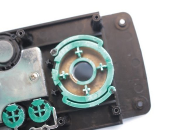

  3. Lightahead DV328 Arrow Button Replacement: crwdns2935265:03crwdnd2935265:01crwdnd2935265:03crwdne2935265:0 Lightahead DV328 Arrow Button Replacement: crwdns2935265:03crwdnd2935265:02crwdnd2935265:03crwdne2935265:0 Lightahead DV328 Arrow Button Replacement: crwdns2935265:03crwdnd2935265:03crwdnd2935265:03crwdne2935265:0
    • Lay the camcorder on its side. The arrow key button is now in full view.
    • There is a small green piece locking in the arrow key button. Once you remove that, the piece will be able to come out.
    • Gently push on the button and it will come out of the device. Replace as needed
