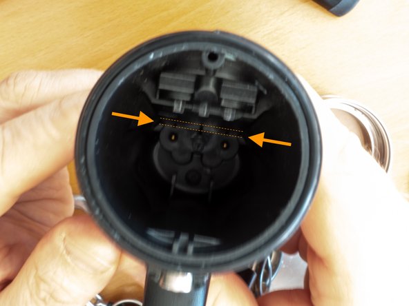

  2. Light and Motion SOLA VIDEO2000  battery Replacement, Remove the light head: crwdns2935265:02crwdnd2935265:01crwdnd2935265:02crwdne2935265:0 Light and Motion SOLA VIDEO2000  battery Replacement, Remove the light head: crwdns2935265:02crwdnd2935265:02crwdnd2935265:02crwdne2935265:0
    • Gently pull the light head by the PCB, not the plastic cover
    • Take note how the light head connector is guided to the PCB connector, all through the plastic cover guide.

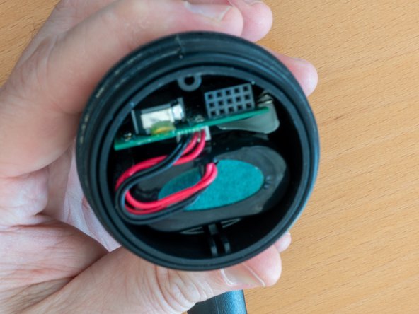

  4. Light and Motion SOLA VIDEO2000  battery Replacement, Remove the PCB and battery assembly: crwdns2935265:04crwdnd2935265:01crwdnd2935265:02crwdne2935265:0 Light and Motion SOLA VIDEO2000  battery Replacement, Remove the PCB and battery assembly: crwdns2935265:04crwdnd2935265:02crwdnd2935265:02crwdne2935265:0
    • Gently shake the lamp and let the battery and PCB slide in your hand
    • Take note of the location where the PCB will have to slide-in during reassembly

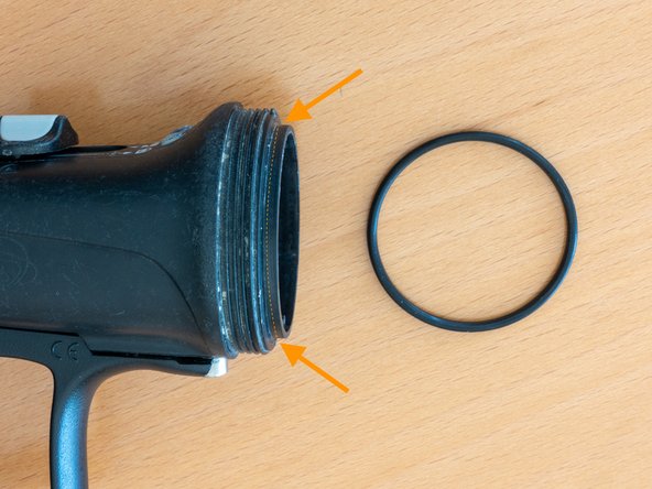

  5. Light and Motion SOLA VIDEO2000  battery Replacement, Remove the O-ring: crwdns2935265:05crwdnd2935265:01crwdnd2935265:02crwdne2935265:0 Light and Motion SOLA VIDEO2000  battery Replacement, Remove the O-ring: crwdns2935265:05crwdnd2935265:02crwdnd2935265:02crwdne2935265:0
    • Gently remove the o-ring, clean it and apply o-ring grease
    • Clean the o-ring seats, both on the body and the metallic cap.

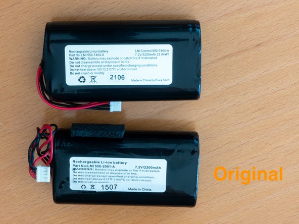

  6. Light and Motion SOLA VIDEO2000  battery Replacement, Disconnect the battery: crwdns2935265:06crwdnd2935265:01crwdnd2935265:02crwdne2935265:0 Light and Motion SOLA VIDEO2000  battery Replacement, Disconnect the battery: crwdns2935265:06crwdnd2935265:02crwdnd2935265:02crwdne2935265:0
    • Gently disconnect the battery from the PCB
    • Avoid touching the metallic strips (humidity sensor, to detect flooding) If it happens, gently wipe it with a dry, non abrasive, cloth
    • Connect the new battery
Use some force to screw back the lamp head cap, but not too much!
After 3 full discharge cycles, the higher capacity battery will give 65min light at full brightness (vs 45 min with the original battery)
