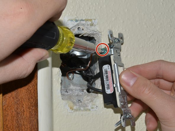

  4. Light Switch Replacement, Unscrew the light switch: crwdns2935265:04crwdnd2935265:01crwdnd2935265:02crwdne2935265:0 Light Switch Replacement, Unscrew the light switch: crwdns2935265:04crwdnd2935265:02crwdnd2935265:02crwdne2935265:0
    • Remove the light switch from the housing by unscrewing the 25.4mm flat head Phillips screws at the top and bottom of the switch, using a Phillips #1 screwdriver.
    • Gently pull the light switch out of the housing.

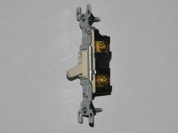

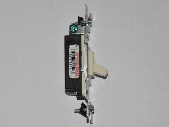

    • Pull the old switch out from the box far enough that its connections can be clearly seen.
    • Confirm that the new switch has all the same contacts (screws) as the old switch, with matching colors.

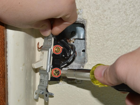

  6. Light Switch Replacement, Disconnect the switch: crwdns2935265:06crwdnd2935265:01crwdnd2935265:02crwdne2935265:0 Light Switch Replacement, Disconnect the switch: crwdns2935265:06crwdnd2935265:02crwdnd2935265:02crwdne2935265:0
    • Take note of the existing wiring since the new switch will need to be wired in exactly the same configuration.
    • There are different ways of wiring switches and your wires may differ from those depicted in number and color. However, if your new switch matches your old switch, simply reconnecting the wires as they were connected to the old switch will ensure proper function.
    • Unscrew the screws on both sides of the the light switch until the wires may be unhooked. If necessary, these screws may be fully removed to prevent the straightening of the wire loops.
  7. Light Switch Replacement, Install the new switch: crwdns2935265:07crwdnd2935265:01crwdnd2935265:02crwdne2935265:0 Light Switch Replacement, Install the new switch: crwdns2935265:07crwdnd2935265:02crwdnd2935265:02crwdne2935265:0
    • Unhook the wires from the screws.
    • These wires will be stiff, do not unbend and straighten out the wires.
    • Begin connecting the wires to the new switch according to the wiring configuration of the original switch.
