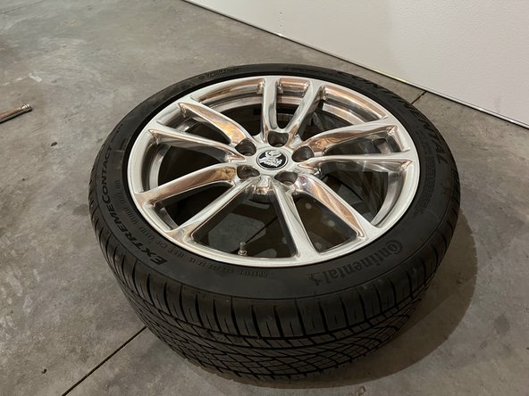

  3. Lift and Support Rear of Vehicle, Breaking the Lugs: crwdns2935265:03crwdnd2935265:01crwdnd2935265:01crwdne2935265:0
    • If removing the wheel, break the nuts before lifting the car with a breaker bar and 22mm or 7/8" socket.
    • If your car was equipped with a spare tire kit, you can use that wrench too.

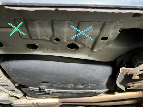

  4. Lift and Support Rear of Vehicle, Lifting: crwdns2935265:04crwdnd2935265:01crwdnd2935265:03crwdne2935265:0 Lift and Support Rear of Vehicle, Lifting: crwdns2935265:04crwdnd2935265:02crwdnd2935265:03crwdne2935265:0 Lift and Support Rear of Vehicle, Lifting: crwdns2935265:04crwdnd2935265:03crwdnd2935265:03crwdne2935265:0
    • When lifting the car, DO NOT use a jack on the pinch welds. Instead, use the plate on the frame rails as shown.
    • When lifting with a jack and supporting with a jackstand:
    • Place the jack here
    • Place the jack stand here
    • I like to place towels or something else soft between the jack / stands and the car to protect the paint
    • Lift the car with the jack until you have the wheel a few inches off the ground. Then insert the jack stand and lower the car onto it.
    • The jack SHOULD NOT be supporting the weight of the car while you're working under it.
  5. Lift and Support Rear of Vehicle, Removing the rear wheel: crwdns2935265:05crwdnd2935265:01crwdnd2935265:03crwdne2935265:0 Lift and Support Rear of Vehicle, Removing the rear wheel: crwdns2935265:05crwdnd2935265:02crwdnd2935265:03crwdne2935265:0 Lift and Support Rear of Vehicle, Removing the rear wheel: crwdns2935265:05crwdnd2935265:03crwdnd2935265:03crwdne2935265:0
    • If removing the rear wheel, fully loosen the lugs and set the wheel aside
When putting the wheel back on, get the lug nuts snug with the rear of the car in the air, then tighten to 100ft-lbs with the wheel on the ground.
