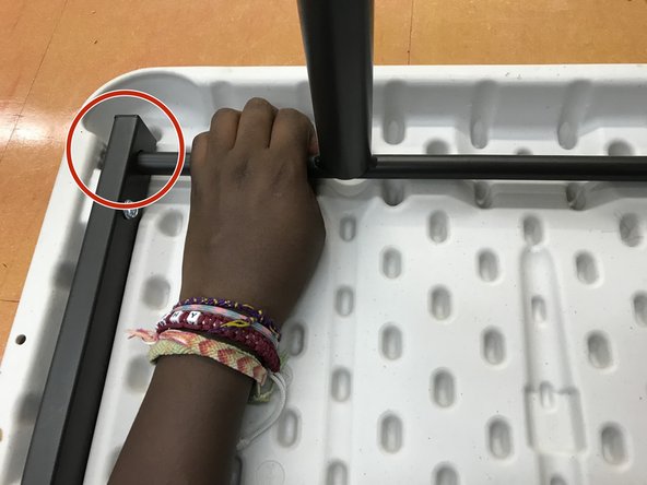

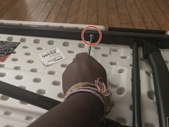

    • Use the 6 mm Flathead screwdriver to remove the four aluminum slotted screws located on the edges of the table.

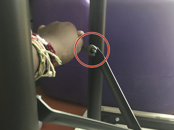

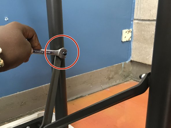

    • Use a 5/32" Allen Wrench or 19 mm wrench to remove the two stainless 8-18 steel hex screws from the braces of the table.

    • Place the two stainless steel hex screws inside of the screw holes located on the leg, and secure each screw with your Allen key or wrench.

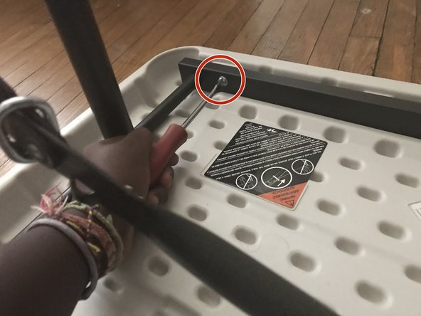

    • Screw the four slotted screws back into the frame using a 6 mm flathead screwdriver. Ensure that the entire side where the new leg is being inserted is securely connected to the table once again.

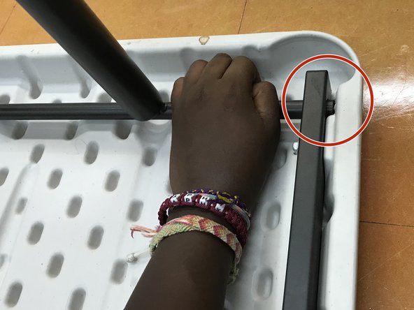

    • Test out the table by unfolding it, and setting it up in a standing position.
    • If the leg is not aligned properly, has loose screws, or missing some screws, make the proper adjustments before using it.
