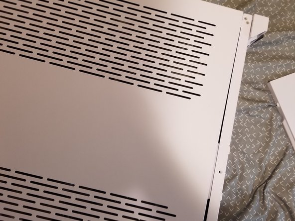

    • Remove two thumb screws from the back of the case.
    • Slide the top panel backwards.
  3. Lian Li PC-011 Hard Drive Replacement: crwdns2935265:03crwdnd2935265:01crwdnd2935265:03crwdne2935265:0 Lian Li PC-011 Hard Drive Replacement: crwdns2935265:03crwdnd2935265:02crwdnd2935265:03crwdne2935265:0 Lian Li PC-011 Hard Drive Replacement: crwdns2935265:03crwdnd2935265:03crwdnd2935265:03crwdne2935265:0

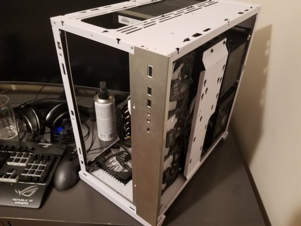

    • Remove the remainder of the panels by pulling upwards on them.

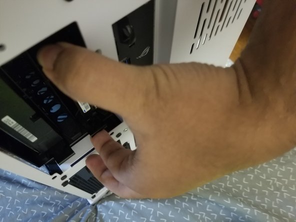

  6. Lian Li PC-011 Hard Drive Replacement: crwdns2935265:06crwdnd2935265:01crwdnd2935265:02crwdne2935265:0 Lian Li PC-011 Hard Drive Replacement: crwdns2935265:06crwdnd2935265:02crwdnd2935265:02crwdne2935265:0
    • Push together the bottom and top tabs and pull the hard drive tray out of the case.

Il ni à pas de languette chez moi et sa veut pas sortir
Antho - crwdns2934203:0crwdne2934203:0
