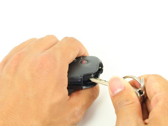

    • Place the keyfob with the removable metal key facing towards you.
  2. Lexus 2011-2015 Key Fob Battery Replacement: crwdns2935265:02crwdnd2935265:01crwdnd2935265:03crwdne2935265:0 Lexus 2011-2015 Key Fob Battery Replacement: crwdns2935265:02crwdnd2935265:02crwdnd2935265:03crwdne2935265:0 Lexus 2011-2015 Key Fob Battery Replacement: crwdns2935265:02crwdnd2935265:03crwdnd2935265:03crwdne2935265:0
    • With the button side facing you, pull the metal latch down towards you to pull out the key.

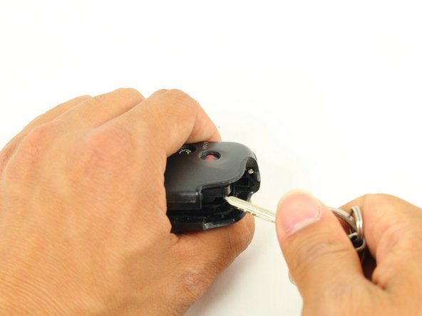

  3. Lexus 2011-2015 Key Fob Battery Replacement: crwdns2935265:03crwdnd2935265:01crwdnd2935265:03crwdne2935265:0 Lexus 2011-2015 Key Fob Battery Replacement: crwdns2935265:03crwdnd2935265:02crwdnd2935265:03crwdne2935265:0 Lexus 2011-2015 Key Fob Battery Replacement: crwdns2935265:03crwdnd2935265:03crwdnd2935265:03crwdne2935265:0
    • With the exposed corner facing you, place the metal key into the slot.
    • Turn the key sideways to open the keyfob.
    • You may feel like you're breaking the keyfob, but be firm while twisting.
  4. Lexus 2011-2015 Key Fob Battery Replacement: crwdns2935265:04crwdnd2935265:01crwdnd2935265:01crwdne2935265:0
    • Remove the battery.
    • Insert the new battery.
