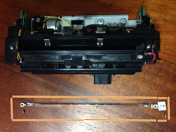

  2. Lexmark T650 Fuser Roller Replacement, Remove top cover: crwdns2935265:03crwdnd2935265:01crwdnd2935265:02crwdne2935265:0 Lexmark T650 Fuser Roller Replacement, Remove top cover: crwdns2935265:03crwdnd2935265:02crwdnd2935265:02crwdne2935265:0
    • Remove these two 6mm #2 screws from the two ends of the heating element and carefully withdraw the glass heating element.
    • The glass heating element is shown in the second picture.

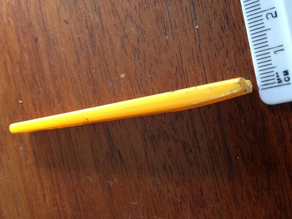

    • Insert a wedge under each of the two spring support arms to lift the two springs.
    • The wedges should remain in place while the fuser unit is being stored. Otherwise the pressure from top roller will make a permanent indentation in the soft pressure roller.
    • The second picture shows a suitable wedge. This example was made from a toothbrush handle.

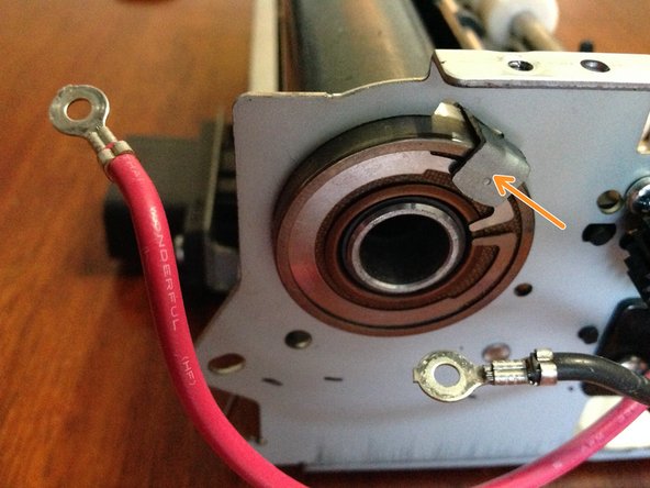

  5. Lexmark T650 Fuser Roller Replacement, Remove top roller: crwdns2935265:06crwdnd2935265:01crwdnd2935265:03crwdne2935265:0 Lexmark T650 Fuser Roller Replacement, Remove top roller: crwdns2935265:06crwdnd2935265:02crwdnd2935265:03crwdne2935265:0 Lexmark T650 Fuser Roller Replacement, Remove top roller: crwdns2935265:06crwdnd2935265:03crwdnd2935265:03crwdne2935265:0
    • Use circlip pliers to remove the circlip attaching the cogwheel to the top roller.
    • Slide this metal catch upwards to release the bearing from its holder. Remove the bearing.
    • The top roller can now be removed.

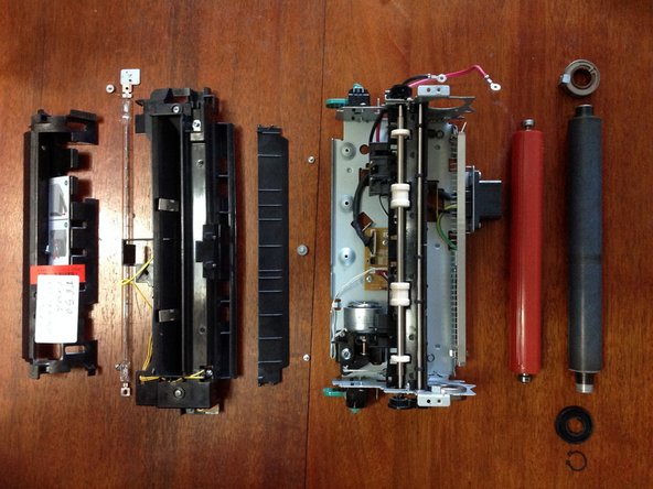

    • The red pressure roller is now visible with its bearings resting in the holder at each end.
  6. Lexmark T650 Fuser Roller Replacement, Remove the pressure roller: crwdns2935265:07crwdnd2935265:01crwdnd2935265:02crwdne2935265:0 Lexmark T650 Fuser Roller Replacement, Remove the pressure roller: crwdns2935265:07crwdnd2935265:02crwdnd2935265:02crwdne2935265:0
    • The pressure roller can now be lifted out.
