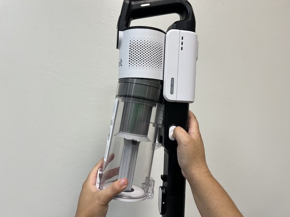

    • Press down on the white oval button located on the side of the vacuum.
    • Hold onto the dust container and pull forward to remove the dustbin.

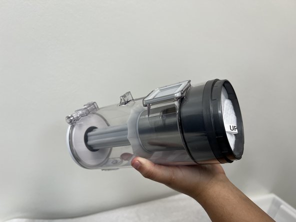

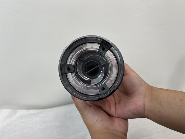

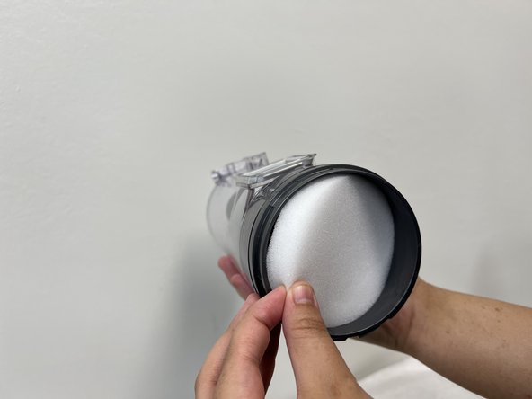

    • Remove both pre-motor filters.

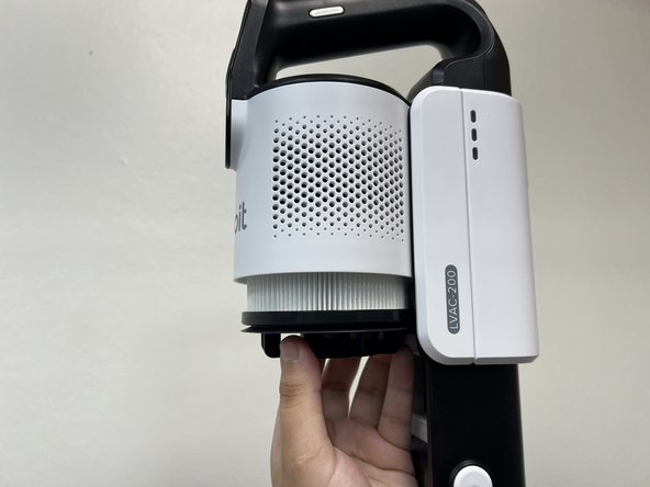

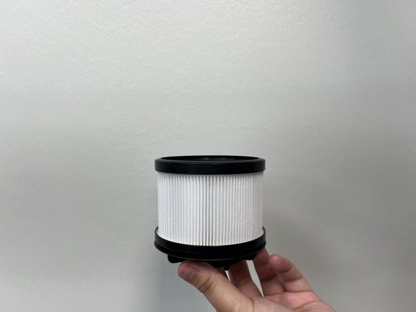

    • Located directly within the vacuum body, firmly turn counterclockwise and pull the HEPA filter downward to remove it.
